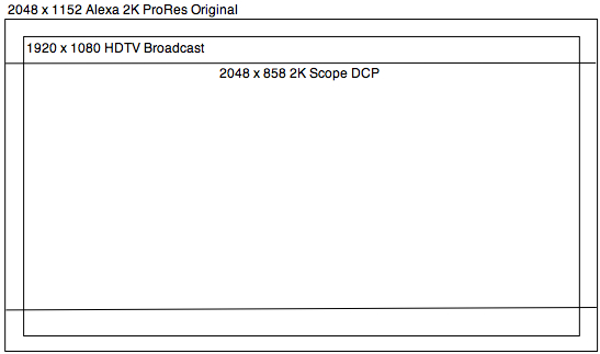

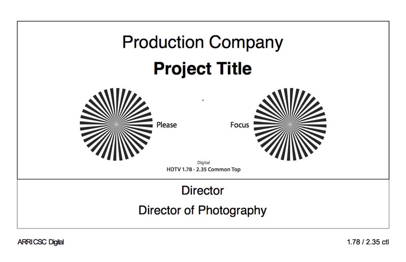

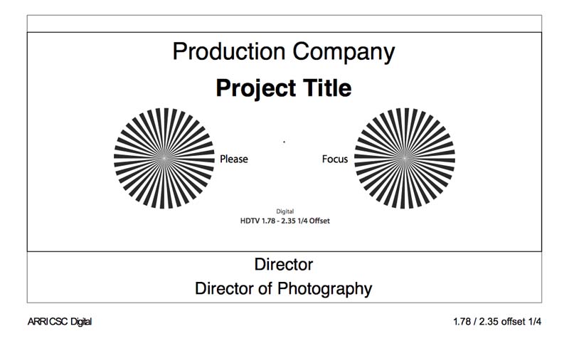

Stuart Brereton Posted January 30, 2015 Posted January 30, 2015 David, Is the 1/4 offset 2.40 different to 'Common top-line'?
Premium Member David Mullen ASC Posted January 30, 2015 Author Premium Member Posted January 30, 2015 True common top shares the same upper frame lines for both aspect ratios.
James Compton Posted January 30, 2015 Posted January 30, 2015 Welcome back to Atlanta, David. What percentage of this production will be stage work vs on-location?
Premium Member David Mullen ASC Posted January 30, 2015 Author Premium Member Posted January 30, 2015 We are almost entirely on location, no sets. At the very end, we have some green screen work for one day that might be on a stage.
Premium Member David Mullen ASC Posted January 30, 2015 Author Premium Member Posted January 30, 2015 This is what the Fincher ground glass at Panavision looks like: http://www.davidmullenasc.com/FINCHER%20GG.pdf This is ARRI's Common Top frame for 2.40/1.78 This is ARRI's 1/4 Offset 2.40/1.78 You can imagine what center crop 2.40 would look like. In the early days of the Sony F900, I did a center crop to 2.40 for about three features (Jackpot, D.E.B.S., New Suit). The problem was mainly that the boom would dip into the space between 2.40 and full frame 16x9 (1.78) and then I'd have to zoom in in post to remove it, forcing me to pan & scan the image slightly, losing the sides. Even without the boom in the shot, half the time the headroom looked too excessive when unmatted to 1.78 and I'd have to zoom in to lose the headroom, again, causing the sides to be lost. But the trouble with true common top is that you have no room for error in framing headroom and there is SO much space below 2.40 that now the issue becomes getting the dolly tracks into the outer 16x9 area, so you're back to zooming in sometimes in post to get rid of stuff at the bottom but with no room at the top to move around. So 1/4 Offset seems to be the best compromise, if you protect all of the 16x9 frame, then it looks OK when you make the non-letterboxed version for broadcast HDTV. I'd still rather see things letterboxed properly to 2.40 for all versions, but you can't always win that fight. At least on blu-ray it generally gets released in the theatrical proportions. 1

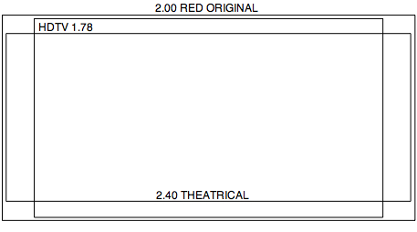

Premium Member David Mullen ASC Posted January 30, 2015 Author Premium Member Posted January 30, 2015 On the three Red camera features I did with Michael Polish, we recorded 2.00 : 1 Redcode, so in this case, we just did a center crop for 2.40, and then the HD 16x9 version was slightly taller but slightly less wide:
Stuart Brereton Posted January 30, 2015 Posted January 30, 2015 True common top shares the same upper frame lines for both aspect ratios. That's what i thought. I've done a couple of movies with Center crop, but the 1/4 offset is a much better idea.
Premium Member David Mullen ASC Posted January 30, 2015 Author Premium Member Posted January 30, 2015 If one were going to use a lot of wide angle lenses with barrel distortion, then you'd want to center crop.
Premium Member David Mullen ASC Posted January 31, 2015 Author Premium Member Posted January 31, 2015 It just occurred to me that another alternative would be to center crop 2.40 but instead of downscale 2048 x 1152 to 1920 x 1080 for home video / HD broadcast, instead crop 1920 x 1080 from 2048 x 1152. This would solve any resizing artifacts since there would be no resizing and would reduce the headroom difference between HDTV broadcast and 2.40, though not as much as 1/4 Offset would. Maybe it's something I'll experiment with on a future project, I haven't heard of any feature deliberately trying this approach. The frame lines would look something like this: Sort of a lower-rez version of what Fincher does when recording 6K on the Red Dragon but framing for 5K inside of that for resizing, reframing, and stabilization.
