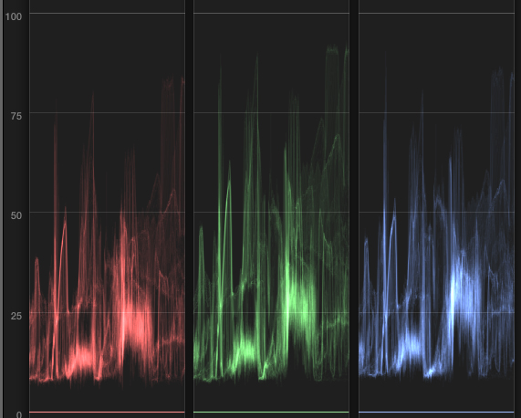

Dennis Hingsberg Posted November 23, 2015 Posted November 23, 2015 post-65277-0-97298800-1436227226.jpg I'd sort of say that a lot of the "look" is coming from grading. Put the original frame with Ben Affleck on some scopes the dark side of his face is 12% IRE and bright side under 40%. Here's what the original shot might have looked like before grading:
