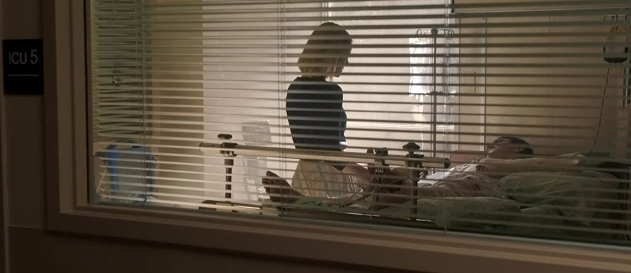

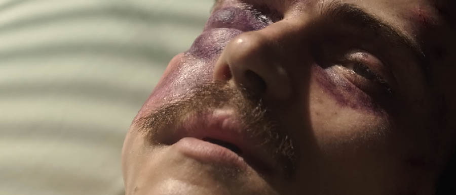

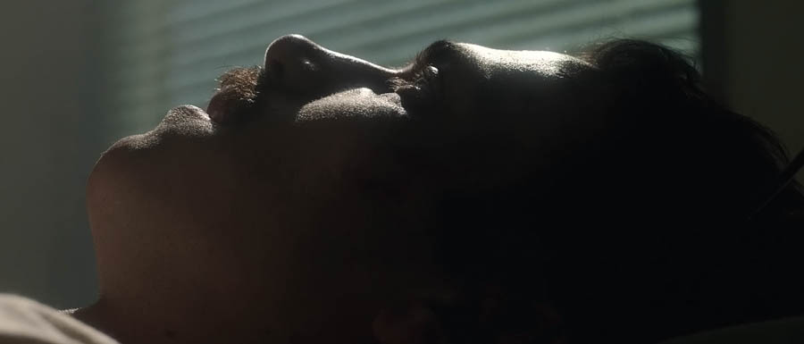

Premium Member David Mullen ASC Posted September 28, 2015 Premium Member Posted September 28, 2015 The wide shot was from another scene just to show you the true room layout. The second and third shots were made at the same time using two cameras and were just shot to build a montage of time passing. No lighting other than an LED eyelight.
Duca Simon Luchini Posted September 29, 2015 Author Posted September 29, 2015 Ah okay, so wide shot confused me. okay, thanks for your reply!
Oron Cohen Posted September 29, 2015 Posted September 29, 2015 The wide shot was from another scene just to show you the true room layout. The second and third shots were made at the same time using two cameras and were just shot to build a montage of time passing. No lighting other than an LED eyelight. Great example Mr Mullen, I personally LOVE to cheat coverage shots all the time, as long as it looks good and feels like it will cut well, why not? Wanted to ask, what did you mean by LED eyelight? is it a specific light? Thanks, Oron.
Premium Member David Mullen ASC Posted September 29, 2015 Premium Member Posted September 29, 2015 Nothing unusual, just an onboard LED light over the lens to get a glint in his eye.
