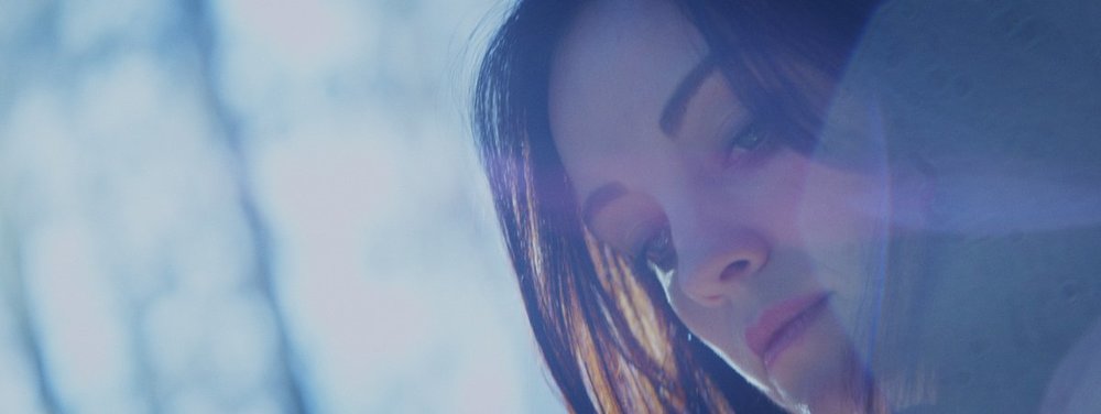

Premium Member Satsuki Murashige Posted October 14, 2020 Premium Member Posted October 14, 2020 Iscorama samples: Red Scarlet, Canon 70-200 f/2.8L, Iscorama 36 MC Red Scarlet, Zeiss ZE 50mm f/1.4, Iscorama 36 MC 1

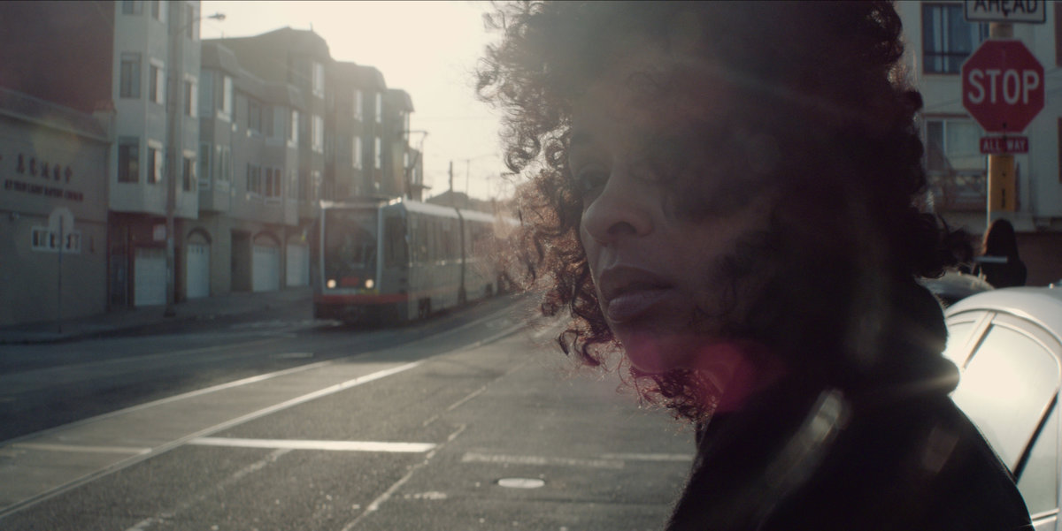

Premium Member Satsuki Murashige Posted October 14, 2020 Premium Member Posted October 14, 2020 Iscorama samples #2: Red Epic MX, Zeiss Contax 35mm f/2.8 MMJ, Iscorama 36 (re-housed)

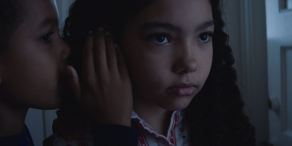

Premium Member Satsuki Murashige Posted October 14, 2020 Premium Member Posted October 14, 2020 Iscorama samples #3: Sony F5, Pentax SMC 50mm f/1.4, Iscorama 36 (re-housed) Sony F5, Zeiss Contax 35mm f/2.8 MMJ, Iscorama 36 (re-housed) Sony F5, Zeiss Contax 50mm f/1.4 MMJ, Iscorama 36 (re-housed) 1
