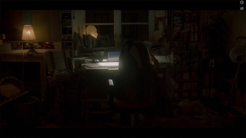

Filip Aladdin Posted December 16, 2020 Posted December 16, 2020 Hi all. Im not that experienced so maybe this is a really dumb question, but Im confused about exposure in low light situations. Let me try and explain this easy. Im usually navigating my exposure with False color on Alexa. And I was shooting a night scene where the actor is drawing on a "light-table" and the rest of the room is dark. Because it is night and she is drawing in a dark room. Nothing strange about that. (you can see on the first attached picture) I wanted most of the room to be dark and black in the end, after post. So I lit it like that. I watched false color and the parts that I wanted dark was purple and blue on false color. Fine I thought. But its noisy and grain in those parts. And im not really sure how to avoid this. Should I have lit the whole room so the parts that I knew I wanted black wasnt black at the time of the shooting? And then make them black in post? Would that get rid of that noise because of the time of the filming it was information. If someone could explain to me the relations between on set exposure and after post, that would be awesome. But maybe its not that easy and im just to inexperienced. I wonder for my self when I watch "real" movies and night scenes where there are parts in the frame that is completely black and is totally clean and no noise. Did they film it like that when they exposed? Were those parts "purple on false color" when they shot it. Or was it 20% and they fixed it In post. (picture 2) If I know I want something black in the end product should I film it that way with no information on the sensor or should I light it and in post make it darker. I hope you understand what im looking and sorry for not using the right technical words. Best, Filip
Premium Member Satsuki Murashige Posted December 16, 2020 Premium Member Posted December 16, 2020 Good question. It depends on: 1. What EI or ISO setting did your shoot at? 2. Did you shoot Log and use the standard Alexa Rec.709 LUT in post? Or did you do a color grade where you lifted the blacks? If you just used the standard Rec.709 LUT to convert your Log footage, then the noise should be normal for that EI. If it’s too noisy for your taste, then simply lower the EI and expose brighter to get less noise. 400 EI is generally very clean on Alexa even for very dark scenes. However, I notice there is no pure black in your frame grab, the darkest object is the letterbox and the shadows are higher than that. If you have lifted the blacks in post, then there will always be more visible noise. Noise hides in the shadows, so by lifting the blacks you are making it more visible. In that case, I would suggest adding more light into the shadows when shooting to get closer to the final image while viewing the standard Rec.709 LUT, so you don’t have to lift blacks in post. Another option would be to create a lifted black Look using ARRI Look Creator that you can view in-camera to see something closer to the final intended look - this would give you the same amount of noise as lifting the blacks in post, but you can see it on the monitor/scopes and it should be easier to judge while shooting. 1
Filip Aladdin Posted December 17, 2020 Author Posted December 17, 2020 Thanks for a fast answer Satsuki! I realise its a bad formulated question and the picture above is not relevant cuz its shot on a black magic 6k. And I don't event think its graded. But maybe this is a better formulated question: What is the "right" way to do for the best end result with least amount of grain and noise in the blacks. If you know that you want crushed blacks in a frame. Do you crush them when u shoot it. 0% exposure on site. Or do you lift them and then crush them in post?
Premium Member Satsuki Murashige Posted December 17, 2020 Premium Member Posted December 17, 2020 1 hour ago, Filip Aladdin said: Thanks for a fast answer Satsuki! I realise its a bad formulated question and the picture above is not relevant cuz its shot on a black magic 6k. And I don't event think its graded. But maybe this is a better formulated question: What is the "right" way to do for the best end result with least amount of grain and noise in the blacks. If you know that you want crushed blacks in a frame. Do you crush them when u shoot it. 0% exposure on site. Or do you lift them and then crush them in post? The advice is still the same with any camera, shoot exposure tests with the final LUT or grade applied to see how much noise (or film grain) is acceptable to you in the dark areas at different ISO levels. Any time you have lifted blacks, like in your Blackmagic 6K frame, you’ll see a lot more noise in the shadows. So if you know you’ll be setting your blacks in post to 0 IRE, then 0% exposure should be fine. But it will depend on the specific camera, as some are noisier in the shadows than others and may need to be crushed more.

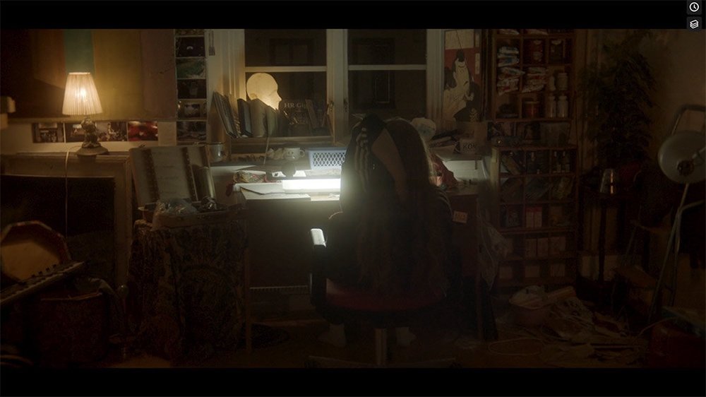

Premium Member Satsuki Murashige Posted December 17, 2020 Premium Member Posted December 17, 2020 I just did this quickly on my phone so it’s a bit rough, but if you crush the blacks on any image you’ll see less noise. There’s no need to change lighting or exposure if this is the result you want. If you want more shadow detail like you had before, then it’s better to add more light into the shadows on set to keep that detail out of the noise floor.
Premium Member David Mullen ASC Posted December 17, 2020 Premium Member Posted December 17, 2020 There's no reason for blacks to be noisy. Black in digital is just zero signal. Trouble is that with underexposed footage your shadow detail is often noisy and if you set the blacks to be pure black with no noise, then the shadows look too dark or look artificially crushed. But you should make a scene as moody as you want. As Satsuki says, either you need to work at an ISO setting where the shadows aren't noisy and/or you need to work with a basic correction / LUT in mind where at least the blacks are darkened so that you will add more light for the level of shadow detail you want -- in other words, you are either using a lower ISO overall or you are essentially lowering the ISO for the shadows, either way you need more exposure to reduce noise. But shadows detail isn't the same thing as black, which mean no detail, it's black! The simpler thing would be to just use an ISO setting that gives you an acceptable noise level and then light it for the amount of mood you want, don't be afraid of shadows or blackness. 1 1

Simon Osaji Posted June 16, 2024 Posted June 16, 2024 (edited) On 12/18/2020 at 1:02 AM, Satsuki Murashige said: #1. #2. I’m battling with exposing lowkey image like #1 Let’s say I’m trying to achieve a final look that is like the #1 image after it is graded, do I expose it like #1 on set, will it remain dense after grade or the shadows will get crushed and I lose details or do I get it like #2 on set then it’s going to look like #1 after it’s graded Edited June 16, 2024 by Simon Osaji
Nicolas POISSON Posted June 17, 2024 Posted June 17, 2024 (edited) You can do almost what you want in post. Using the 'lift' tool would crush the blacks. Using the 'gain' tool would lower everything proportionally, keeping some details in the shadows. The 'gamma' gives you more latitude. These are the most basic tools. A colorist could use more advanced techniques. Any correction that goes toward reduction (lower exposure or smaller gamut, i.e. washed out colors) will always be easy, since you are lowering the noise (analogue domain) or getting quantization steps closer (digital). When increasing exposure in post, or pushing colors, there is a risk to get noise, or artifacts from quantization, camera built-in noise reduction, and compression. Edited June 17, 2024 by Nicolas POISSON
Simon Osaji Posted June 17, 2024 Posted June 17, 2024 What if you don’t have any input in the post work process, and the final look agreed upon is the #1 image, would you deliver the look exactly like that?
Nicolas POISSON Posted June 18, 2024 Posted June 18, 2024 I am not in the pro game enough to claim how it should be done. However, transmitting information about exposure, white balance, intended mood... from the DP to the colorist seems definitely a question nowadays. There is no unique answer. If ISO tells about the exposure, the colorist has enough piece of information. Say you have shot at ISO 200 and the sensor native ISO is 800, the colorist knows he/she should lower the exposure by 2 stops in post. The grading software may even do it automatically. But if ISO does not represent the exposure, which happens typically when using compensated LUTs on an external monitor, then the colorist cannot know. This is where you should agree with the colorist on how you communicate.
