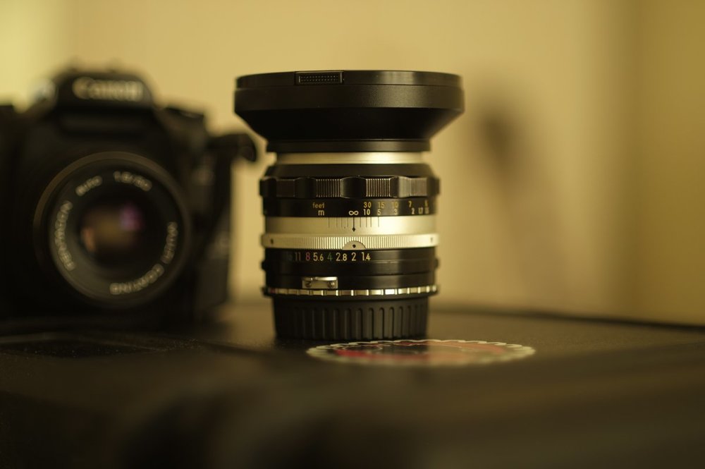

Stuart Brereton Posted February 28, 2021 Posted February 28, 2021 (edited) This is an interesting question. I just had a quick play around with an old Sigma Achromatic close up diopter. I have no idea of its power. It was bargain bin find some years ago. I set up a little still life, and took two pics. First was with the lens (50mm f1.4) focused at infinity, with the achromat, which brought the focus to 2' 6". Second frame was without the achromat and focused at 2' 6". There was tiny shift in image magnification between the two, with the diopter shot being slightly larger in frame. DoF appeared very slightly shallower on the diopter shot.There was a marginal difference in sharpness, but that was more than likely down to focusing error on my part. The differences were small enough to make no difference in my opinion, but of course, others might say otherwise. As to why your DP was doing it, there may be a good reason, or it could just be down to a personal shooting quirk. Edited March 10, 2021 by Stuart Brereton Incorrectly stated that diopter shot was smaller in frame, not larger

Stuart Brereton Posted February 28, 2021 Posted February 28, 2021 38 minutes ago, David Mullen ASC said: I thought diopters did not actually change DOF If they do, it's marginal. If you look at the word Canon in the pictures, you can see that it is very slightly less blurred in the second one, which was taken without the diopter. It's such a slight difference that it's hardly noticeable.

Stuart Brereton Posted March 10, 2021 Posted March 10, 2021 1 minute ago, Alissa Alexina said: So, if a close background is almost in focus, the defocus effect from the diopter looks really noticeable. But it doesn't, that's the problem. In my first two stills, the Canon camera is just a few inches behind the in-focus lens. The wall behind it is 7 feet back. The camera appears equally soft in both frames, as does the wall. In Pete's second post, he clearly states that the background was 50' away
