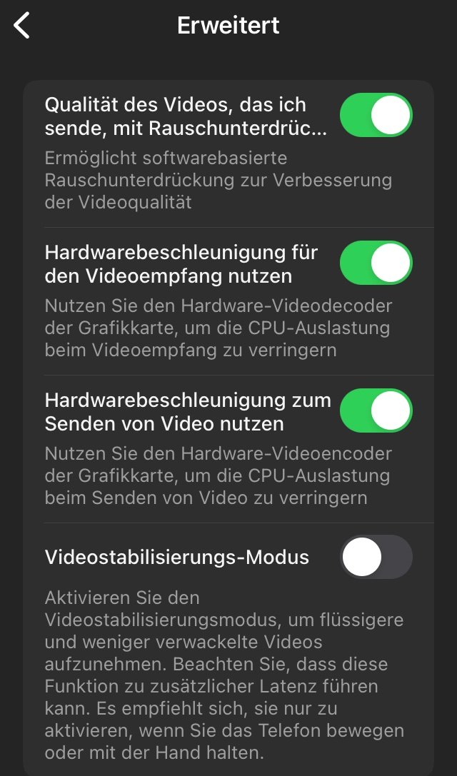

Joerg Polzfusz Posted September 2, 2024 Posted September 2, 2024 Hi! There are several options in Zoom that can be set by the sender and by the receiver: deshake, denoise, deflicker, … . (Screenshots from the German iPhone version) It’s hard to tell whether it was an incorrect setting on your or the organizer‘s side.

Premium Member Stewart McLain Posted September 5, 2024 Author Premium Member Posted September 5, 2024 @Joerg Polzfusz Those settings might have had something to do with it. I'm still curious as to what I could do to protect my images in the future. I mean, it's not possible to to light up the darkened corners of the Batcave or Don Corleone's inner sanctum just by tweaking a few settings on Zoom, right?
