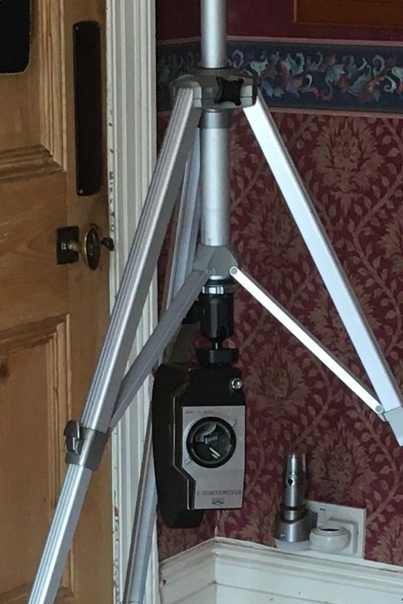

Mark Dunn Posted October 4, 2024 Posted October 4, 2024 (edited) I'm sure there used to be amateur trick prisms for inverting the image but I'd be surprised if you could find one to cover a lens of any size. It shouldn't be too difficult to rig an upside-down camera. The Bolex isn't that heavy so you might even be able to make something up out of angle brackets, or a rental house may have some ideas. I would certainly be in the garage with some nuts and bolts and bits from Screwfix or Toolstation if I had to do this. A tripod with a reversible centre column might work- put the head upside down. My amateur Velbon can do this. The camera would be much lower than usual. Edited October 4, 2024 by Mark Dunn
Mark Dunn Posted October 4, 2024 Posted October 4, 2024 (edited) I'm professionally ashamed of how crappy this image looks, but taking pix on an Iphone is much too easy and there's a size limit on the forum. You get the idea though. You may need a shorter camera operator lol. Edited October 4, 2024 by Mark Dunn
Graham Ellard Posted October 4, 2024 Author Posted October 4, 2024 Thanks for the suggestion. With a drive motor, 400ft mag. and winding motor, the Bolex does become pretty heavy, so hung below rather cantilevered outwards is probably the best solution. But as you say, it could be very hard to get to the eye piece!
