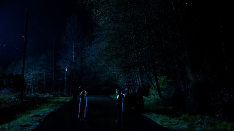

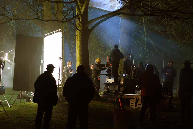

Saul Rodgar Posted April 6, 2008 Posted April 6, 2008 Love your third still David, the wide shot in the woods looks very moody. I agree, the interplay of the blue moonlight 18k HMI and the more warm foreground light which brings out the green in the trees is really nice. You mentioned all the lights were HMI's, however, the 18 K looks a lot more blue in relationship to the overhead balloon and the joker. Were any of them gelled, or is this one of the DSLR innacuracies?
Michael Grugal Posted April 6, 2008 Posted April 6, 2008 (edited) David your stills photographer was shooting 400 ISO at an f2.8 at night? How long was his exposure? Edited April 6, 2008 by Michael Grugal
Premium Member David Mullen ASC Posted April 6, 2008 Author Premium Member Posted April 6, 2008 David your stills photographer was shooting 400 ISO at an f2.8 at night? How long was his exposure? He was shooting at f/2.8, but at 800 ASA with a 1/100th shutter, whereas I was at 400 ASA with a 1/48th shutter, more or less the same exposure. I didn't gel any of the lights in the woods shot, but this was uncorrected on my still camera set to 3200K whereas I plan on timing some of the blue out in the D.I., so in Photoshop, I subtracted a little blue and added a little red and green; this shifted some of the colors of things. I think the main reason the background light looks bluer is that the foreground light is hitting a brown tree trunk & green moss.

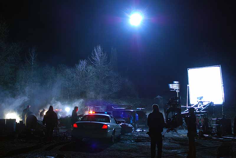

Premium Member David Mullen ASC Posted April 13, 2008 Author Premium Member Posted April 13, 2008 We've been working a week of nights, with one more week of it to go -- you never really get used to working from sunset to sunrise everyday and then going home to bed... Plus there are less than 11 hours of true night, so it's always something of a rush at the end to finish up as the sky is lightening. We did our second day in the suburban park on Monday, which I lit with tungsten streetlamps (w/ 500w bulbs in them) plus tungsten lights coming from off-camera -- then I had the dailies timed with a half-orange look by shooting the grey scale under a 3200K light with half-blue gel on it. Just for some variation from the many blue moonlight scenes that we have. We had a long dialogue scene under a tree in the park, which I lit mostly from one side with a soft light, and a backlight from a condor (an 18K HMI with Full CTO on it.) Here is a shot of us at work -- the scene itself was exposed much darker than what you see. The frame of Half Soft Frost in the tree tops is not for lighting, but to keep the rain drops off of the actors. The week started out very cold and drizzly (but now it's sunny & warm today.) This shot of the stand-ins is closer to the look (sorry but the focus is off in my snapshot). This photo is of the master, whereas the crew photo above was done while shooting one of the close-ups, where I switched to a much larger soft light: Tuesday was spent finishing coverage under that tree and then moving down the road to shoot a stunt; because the car comes down one road, makes a turn, and makes a sudden stop on the next road, I had to look wide down three directions on two roads, needing a condor at three ends. Even though I lit two blocks up for moonlight, the director was still concerned that we didn't have enough roadway to get a sense of the driving, but all through the week, I essentially was lighting a couple of football fields of night exterior up and it was never quite enough for all the screen action. But it certainly made lighting go very slowly, being areas with no available light (and the location was supposed to look isolated anyway, so a lot of streetlamps or storefront lights made no sense.) Wednesday we moved across town to a undeveloped parkland area, where a roadside tavern (three-walled exterior front only) was built for the production and then blown-up & burned down by the end of the first day, after which we shot aftermath scene on the following days. First time I've shot a major fire scene; I tried to get the light levels up, close to an f/4, so that the fire would not burn-out to white too much. This was a case where the extended overexposure range of the 5219 stock seemed to help because the fire kept its orange color. The surrounding area of the tavern, the parking lot, had a metal halide lamp on a pole at each end with I augmented with a light on a high condor with a similar color (HMI with 1/4 CTO + 1/2 Plus Green). The hard part was lighting a scene without a big fire going and then turning on the fire just before we rolled. Here is a shot of us shooting the aftermath scene. The art department got me three halogen work lights to dress in the rubble as if the investigators had set them up; I also backlit everything with an 18K HMI (no green this time) on a condor and added a soft fill from one side with a 4K HMI bounced into a 12'x12'. Again, this photo was exposed brighter than how I exposed the scene: We had a 40' GFM crane with a Libra head on it. We ended the week in the woods shooting coverage for a scene where the master will be shot next week. The reason is because the wide shot will be done at night in the mountains next to a big waterfall (which is a huge area to light) and the sound of the waterfall is deafening, not the mention that the site is remote and hard to light. So we shot reverse angles in the trees of the park for all the dialogue. Besides the moonlit look, the question was what other sources we might have -- we had some flashlights for when the characters walk through the woods to the spot, but the scene action meant that the characters shouldn't be holding flashlights anymore. I thought about having them hang a camping lantern (and the ones I was shown by the art department had green fluorescent bulbs in them, so there was some discussion of how to convert it to tungsten) but then in the last minute, we got permission by the park (and the park where the waterfall is) to use a burning torch for the scene (it makes sense story-wise) -- the efx people rigged up a propane-fed torch that was propped up in the center of the space. Then I just augmented the light with some flickering orange off-camera. All week of nights, I sort of alternated shooting some scenes at 400 ASA with normal processing and 640 ASA with a one-stop push -- mainly it depended on balancing to other sources like flashlights -- I pushed the film when I didn't want to overpower those sources. In two cases above, the photos, I didn't have to push the film -- the park was lit to an f/2.8 generally at 400 ASA, and this aftermath scene with the police and fire trucks was lit to an f/2.8 at 320 ASA. However, I then switched to 640 ASA with a one-stop push for the flashlight & torch-lit scene in the woods.
Evan Winter Posted April 13, 2008 Posted April 13, 2008 Great looking stuff David. I believe I can see the final look in my mind's eye. :) And I'm not sure if it's the angle the photo was taken at or on account of something else but the 18k HMI on the condor looks like it's incredibly high up! Thanks again for the notes and thoughts. Evan W.

Ram Shani Posted April 20, 2008 Posted April 20, 2008 (edited) thanks David for the detail info about your production. just wounder why you didn't use helium HMI balloons outside? want it be easy to get them high up and move them out of frame. maybe put them up high above the camera so you could shoot 360. wouldn't they look more natural as moonlight? Edited April 20, 2008 by Ram Shani
Premium Member David Mullen ASC Posted April 20, 2008 Author Premium Member Posted April 20, 2008 It's hard to get a helium balloon to go 100' in the air actually, but of course in the midground, it doesn't have to get as high as a backlight in the background. A balloon is just a different look for one thing -- the location becomes top lit, not backlit, and everything beyond the balloon is front lit. You don't get hard shadows. This being a horror film at times, I want sharpness, contrast and deep shadows for some of the night scenes. I've used balloons as well in some scenes at night when it makes sense. But it really is a soft light that goes everywhere. The moon is actually a hard source in real life, just like the sun, so what's "natural" is just a matter of personal taste. Plus, being a semi-horror film, naturalism isn't always the right approach when you are trying to heighten the tension of some moment. I had thought of a balloon for the night rural road scene, but I was worried about not creating the right mood for the scene. It was a flashback describing some horrible night and I wanted it to be contrasty. It's also hard for a balloon to put out enough light for some of the large areas I'm dealing with. But the main problem with them is the height and the fact that the wind can drive them down towards the ground. The empty housing street location probably would have been better if I had created a "moon box" on a construction crane (similar to a balloon light look), not so much to be able to shoot 360 degrees, just to be able to shoot low-angles with wide-angle lenses -- but construction cranes are out of our budget. Besides, I liked the deep shadows on the street from the single backlight source.

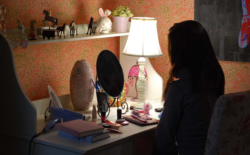

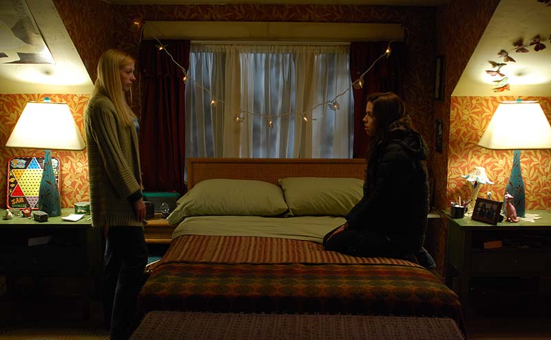

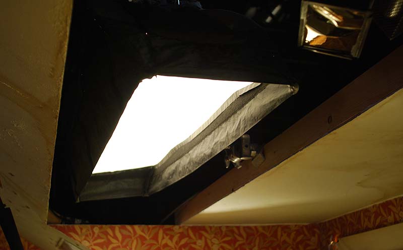

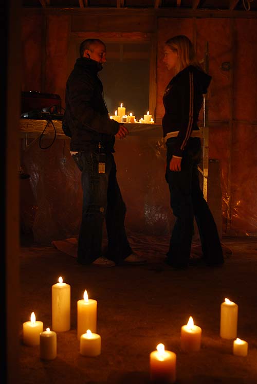

Premium Member David Mullen ASC Posted April 26, 2008 Author Premium Member Posted April 26, 2008 Just finished Week Six. Spent the whole week on a soundstage, which was nice and comfortable… but caught a heavy cold on Wednesday, not so nice. Monday and Tuesday were spent on one bedroom set, Wednesday in a set presenting the second floor of a house under construction (with open wooden framework, plastic sheets, and pink insulation), and Thursday and Friday in another bedroom set. All the scenes were night interiors, some with room lights on, some where the lights go out and the room is lit by moonlight. The construction site room was lit by candlelight and some moonlight. The first two photos show some of the simple lighting set-ups for a night interior. First is one of our stand-in Tiffany sitting at a desk, lit from frame left by a tungsten lamp (1K I think) through both a Chimera and then a diffusion frame. There is some fill coming from a single diffused 2’ Kino tube plus the bounce from the real desklamp coming off of the keyboard. The backlight is from what my Gaffer, John Dekker, calls a “half dome” – a narrow Chimera (sometimes 1’x4’) with a homemade fixture inside that holds three or four 213 lightbulbs on individual switches, sort of similar to the concept of a bat strip. He has some smaller 3-globe versions and larger 4-globe versions. The second photo has Tiffany lit from frame right by a tungsten lamp coming through the window above the bed, through a diffusion frame (not that scene was supposed to be lit by the window, just that the opening was convenient to shine the light through.) Everything has ¼ CTO on it: The bed was difficult to light because it was set into a window box alcove with a low sloped roof above it. For angles looking straight at the bed, I opted to cut an opening in the alcove roof (advantage of being on a set) and hide a half-dome light up there for a soft toplight: Here is a photo of the half-dome crammed above the bed in the opening we made. There is a little 400w softlight next to it that fades up at one moment to highlight a darker corner of the bed where someone’s head ends up, just to keep things from getting too underexposed: The construction site room was lit by candles in the scene. We had a mix of single and double-wicked beeswax candles (the double-wicked made by a candlemaker in Vancouver, and they are not cheap and melt twice as fast as a single-wick candle.) I added a weak amount of soft orange light to allow me to shoot at an f/2-2.8 split at 400 ASA, with the faces about one and half stops underexposed. On the close-ups, I increased the light level so that I could shoot at f/2.8 with the faces only one-stop underexposed. Again, these are stand-ins: In the second bedroom set, I lit a scene of someone sitting at their mirror with just the real practical lamp next to the mirror, and some weak blue light in the background reflected in the mirror. I thought the practical up close to the face provided a nice soft key light. We dollied from the wide shot until we saw the face revealed in the mirror. The only snag was that the actress found it hard to apply make-up in the scene with the mirror angled for the camera to see her, not for her to see herself. But she pulled it off. Excuse my poor Photoshop skills erasing the face of our lead actress in one of the photos on the desk... The shot was partially a happy accident -- we dollied into the mirror, revealing the sad expression of the actress but there happened to be a photo of the smiling face of the actress on the desk, so I cheated it in next to the mirror for the visual juxtaposition. Most of what we shot on Friday and through next Tuesday is a climatic scene in that small bedroom, a fight in the moonlight. It’s difficult because the action takes place both on a bed and several feet in the air towards the ceiling where the moonlight from a window would not normally reach, so I have a lot of cheating to do. Combine that with the fact that some of the action will be shot at 1000 fps on Monday or Tuesday with the Phantom camera (Kevin Zanit has come out here to help us on that portion) so I have to light those shots inside the room to around an f/16-22 split just to get an f/2.8! I have one of the best crews that I have ever worked with on this show, so it’s been a real pleasure. Every department, even the ones not under my supervision, are doing amazing work. Not a single weak-link, which is rare actually.

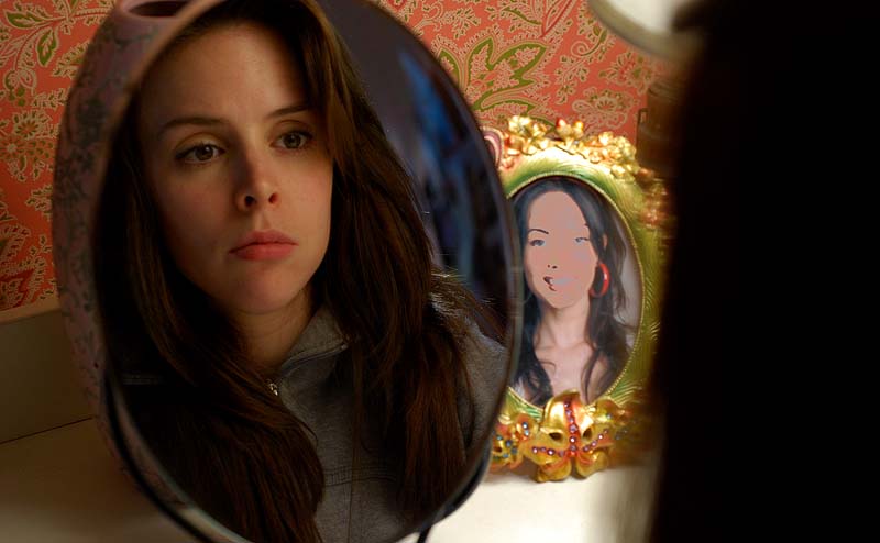

James Steven Beverly Posted April 27, 2008 Posted April 27, 2008 (edited) Excuse my poor Photoshop skills erasing the face of our lead actress in one of the photos on the desk... You mean Megan Fox? Why are they making you treat this like some kind of a national security issue? They are aware IMDB has a whole thing on Jenifer's Body with a complete cast and crew list including pictures and your name as cinematographer, right? http://www.imdb.com/title/tt1131734/ You having to Photoshop the shot seems a bit silly to me....but what the Hell do I know. :rolleyes: Edited April 27, 2008 by James Steven Beverly
Premium Member David Mullen ASC Posted April 27, 2008 Author Premium Member Posted April 27, 2008 Everyone who works on a movie these days signs a non-disclosure agreement so that the production controls all information about the production, including images (especially images). By keeping thing dry and technical, and non-specific about the plot (even though the script was leaked online a year ago), and just using digital snapshots of stand-ins in lighting set-ups, I hope that I will be allowed to post what I do... because I feel it is educational. As for erasing an actress's face, well, I don't have permission to really publish anything, so I'm not going to go so far as to release photos of the actors, especially not one being hounded now by paparazzi...
