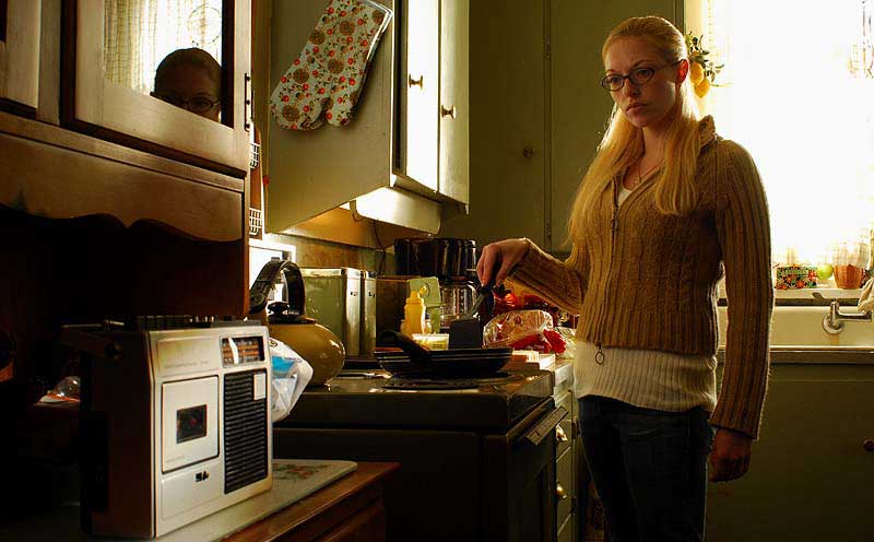

Premium Member David Mullen ASC Posted April 1, 2008 Author Premium Member Share Posted April 1, 2008 We're just starting Week Three, but I wanted to just cover Week Two. The first four days were spent at one house, belonging to the main character. We started with some day scenes -- I lit a kitchen mainly with a 12K HMI coming through a window through 1/2 CTO as a warm backlight, the stuck a piece of white card on the wall to reflect it back into the face of our main actress. Looked natural. But the hard scene that we spent nearly two full days on was a suspense scene inside the house with no lights on, which was particularly hard because the main corridor in the house was windowless and covered with dark brown wallpaper. So I had to hid various lights that were gelled half-blue for moonlight to rake the walls and bring out the character as she moved through the space. I used the Kinoflo Kamio ringlight quite a bit for an eyelight as we followed our lead actress in close-up on a Steadicam. It often had ND3 or ND6 to knock it down. I also often black paper-taped the upper half of the ring to make it more of a lens light below the lens. But the Kamio does a nice job of giving you a glint in the eye without a donut ring effect. We ended the week at a mental hospital location shooting a cafeteria scene, mostly lit by rows of fluorescents that the art department hung in the ceiling. Decided to go Kubrickian and use a 14mm lens as we tracked through the space. We ended the night out on a road shooting a long walk down a moonlit road. I had two 18K HMI's on a 125' condor way down the road -- because the road was naturally wet (this is Vancouver after all) I was able to shoot at an f/2.8 despite the fact that my meter said there was much less light, because of the glare off of the road from the backlight. We shot the wide shot on a 150mm lens for a telephoto effect where you see the person in silhouette walking downhill as they are backlit by the moon. I've been using my DSLR (Nikon 40X) as a quick double-check on my exposure choices -- it is particularly helpful in night situations, but it is only a rough indication of the final effect. Only used a little of the 200T 5217 stock for a daytime walk-n-talk on a Steadicam; otherwise I've been shooting 5219 all week. Quote Link to comment Share on other sites More sharing options...

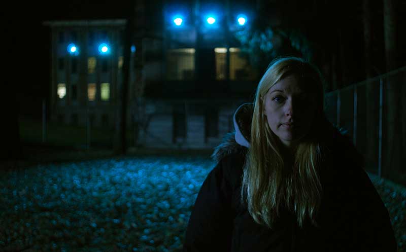

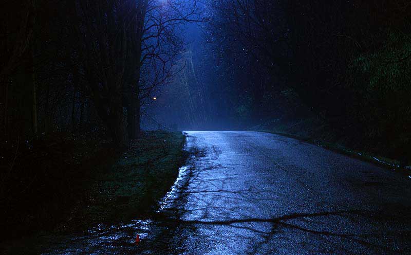

Premium Member David Mullen ASC Posted April 6, 2008 Author Premium Member Share Posted April 6, 2008 I'll post some of my exposure snapshots here just once, though I won't be able to do much of that until after the movie is released. The person in the photos is the lighting stand-in. This is a shot of a road I lit. This was a case where the incident meter told me that I had a T/1.4 at 400 ASA, but because of the glare off of the wet road (it had just rained, we didn't do that -- and the mist in the air was natural too), my DLSR said it looked better at a T/2.8, which by coincidence is also what our stills photographer was shooting at. It was backlit with an 18K HMI on a 100' condor at the far end of the road; another HMI on the same condor pointed at the opposite direction to front-lit the far end of the trees: This is a day interior lit with a 12K HMI PAR going through 1/2 CTO for a warm look; the light on the face was just the bounce from the backlight -- I put a white card on the wall to catch the light back into her face but even that was too much so I clamped a single net to the white card to make it more of a grey card. There was a slash of light on the radio from a tungsten Source-4 with 1/2 CTB: This was a shot from Friday night of some woods, backlight from a far away condor, again with an 18K HMI on it. I also had an HMI lighting balloon overhead, dimmed down. At the last minute, I added a rake across the foreground tree trunks with a small HMI Joker. (In this case, we added the slight mist in the air). I shot at a T/2-2.8 split at 640 ASA (one-stop push): This was the night shot of the building where I added the HMI Jokers with Plus Green on them for a metal halide security light look (T/2.8 at 320 ASA): Quote Link to comment Share on other sites More sharing options...
Premium Member Max Jacoby Posted April 6, 2008 Premium Member Share Posted April 6, 2008 Love your third still David, the wide shot in the woods looks very moody. Quote Link to comment Share on other sites More sharing options...
