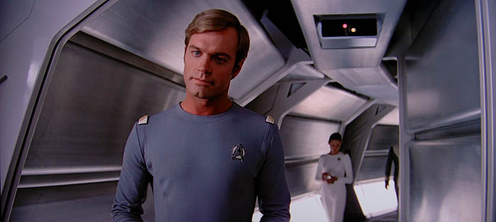

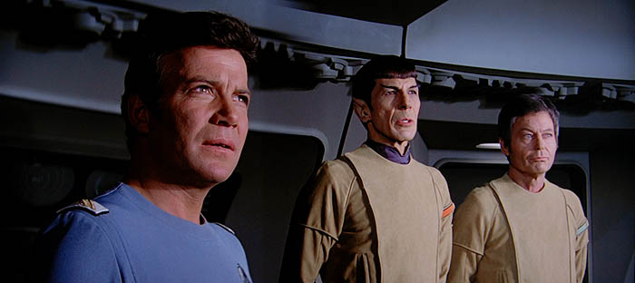

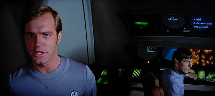

Tom Lowe Posted May 27, 2009 Posted May 27, 2009 I cannot even tell where the split is exactly on a lot of these. Do these types of shots need to be static, with the camera locked off?
Tom Jensen Posted May 27, 2009 Posted May 27, 2009 I cannot even tell where the split is exactly on a lot of these. Do these types of shots need to be static, with the camera locked off? The first one (and two) is pretty obvious. You can see the split on the guard rail. The second one is a little less obvious but it looks to me like it is on his arm and behind his chair. The 4th photo doesn't have one. You don't normally pan or tilt with a diopter. I was just thinking of some other episodes that I liked. "I, Mudd" was pretty funny. Then there was the Nazi episode and the Rome episode. The fight was my favorite. Didn't Mike Meyer re-enact that in Wayne's World?

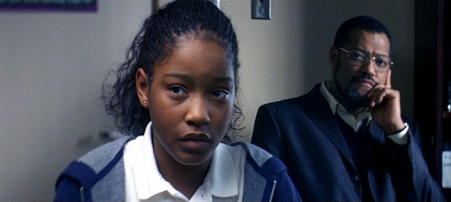

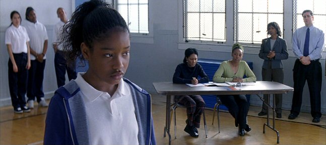

Premium Member David Mullen ASC Posted May 27, 2009 Author Premium Member Posted May 27, 2009 I used a split-diopter here on "Akeelah and the Bee" - it barely cuts through the corner of the table: For comparison, here I used a tilt-focus lens: I've carried a tilt-focus lens on a couple of movies, but I rarely get a director who understands effective deep-focus staging, so the lens ends up never being used. 1

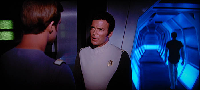

Guest Tim Partridge Posted May 28, 2009 Posted May 28, 2009 I think the diopter stuff in TMP is extremely intrusive and distracting, on vhs, laser, dvd and in the theater (haven't seen the blurays yet, but the screengrabs look oddly mushy in parts, presumably due to DNR.) By comparison the diopter's in HINDENBERG and ANDROMEDA STRAIN, two prior Wise pics, worked just fine. I assume the mushy lighting does little to camouflage the seam lines on TMP. Andromeda Strain or not, to my mind ST:TMP is still hands down the most visually appealing Trek movie by some distance. I agree with you regarding WOK's visual effects work. I also think James Horner's score is admirably dignified given how uncinematic (and grossly underwhelming) the other production values are.
Tom Lowe Posted May 28, 2009 Posted May 28, 2009 So, David, with a shot like the one above, do you have to kind of explain to the actors and crew what you are doing with the split filter? Is everyone on set, more or less, aware of what type of shot this is -- that it's "special" or whatever? Or do you just say, "Stand here and don't move too much"?
Premium Member David Mullen ASC Posted May 28, 2009 Author Premium Member Posted May 28, 2009 Well, I'm not sure if I went into detail with Keke Palmer (Akeelah) as to what a split-diopter filter was... but I do describe the shot to whoever it affects. Actually in this case we did a take with and without the filter because she had to cross to the table in the background. But even on the take with the filter, you don't notice too much when she crosses through it. But that's just luck to some degree. So sometimes I just warn the editor that there was a split-filter if I let the actor cross through it, in case they want to cut around it. The reason for the deep focus effect was simply that during parts of the spelling bee, she answers questions tossed at her by the moderator in the b.g. and we didn't want to have a lot of focus racks back and forth with each question and reply, though we also did a take like that in case the split-diopter didn't work, plus for moments when the moderator isn't talking, it was good to have a version where the focus was only on Akeelah.
Chris Burke Posted May 29, 2009 Posted May 29, 2009 Well, I'm not sure if I went into detail with Keke Palmer (Akeelah) as to what a split-diopter filter was... but I do describe the shot to whoever it affects. Actually in this case we did a take with and without the filter because she had to cross to the table in the background. But even on the take with the filter, you don't notice too much when she crosses through it. But that's just luck to some degree. So sometimes I just warn the editor that there was a split-filter if I let the actor cross through it, in case they want to cut around it. The reason for the deep focus effect was simply that during parts of the spelling bee, she answers questions tossed at her by the moderator in the b.g. and we didn't want to have a lot of focus racks back and forth with each question and reply, though we also did a take like that in case the split-diopter didn't work, plus for moments when the moderator isn't talking, it was good to have a version where the focus was only on Akeelah. David, How is the framing for TOS? Do they have black bars left and right? Or do they crop the top and bottom? I am becoming used to pillar bars, but reluctantly so. For what it is worth, Star Trek: The Motion Picture, was the most magical for me. It had a certain quality scrubbed out of all the others, till the latest. chris
