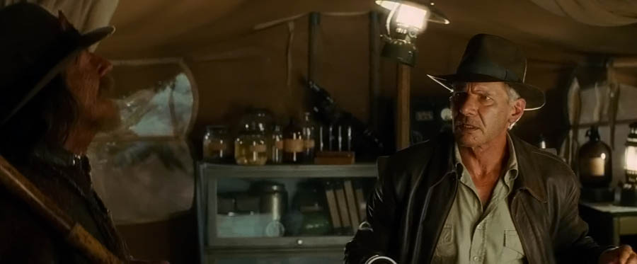

Premium Member David Mullen ASC Posted July 17, 2016 Author Premium Member Posted July 17, 2016 it doesnt seem like Kaminski really uses them except on medium and wider shots. Kaminski has shot plenty of close-ups with nets... "Minority Report" is full of them: But sometimes he seems to switch from a net to a Classic Soft when the flare pattern from the net is too distracting for that shot. There are a few scenes in "Indiana Jones and the Kingdom of the Crystal Skull" shot on nets, not as many as use Classic Soft or no filtration, but in this scene, it begins by using nets and then switches to Classic Softs for most of the later coverage -- look at the flare from the hanging lantern: Net Classic Soft As for nets not being as nice on close-ups, we'll just have to agree to disagree, I tend to think that's when they work the best but mainly because they are usually too heavy for wider shots. It was probably "Fiddler on the Roof" that first got me interested in nets, most of the movie was shot with a brown pantyhose stretched over the front of the lens. There is a behind-the-scenes photo of Ozzie Morris at the Panavision PSR camera with a pantyhose just held over the nose of the lens with a rubber band and the rest dangling down; I'm not sure if that was a gag shot since you'd normally put a matte box in front to keep ambient light off of the net.
Premium Member David Mullen ASC Posted July 17, 2016 Author Premium Member Posted July 17, 2016 Looking through "Minority Report" again, it's mostly shot with nets: It's hard to talk about filters used on wides, mediums, and close-ups in a Spielberg film, particularly this one, because almost every shot moves from one to another, a close-up has a rack-focus and pan into a wide, a medium moves into a close-up, etc. What you'll notice about Kaminski's work was that it was fairly clean up through "Jurassic Park: The Lost World" (1997) but after that, he started using silver retention printing processes and diffusion. You see a few scenes shot with nets in "Amistad" (shot the same year as "Lost World"), particularly the final Supreme Court arguments finale, then "Saving Private Ryan" (1998) isn't filtered much, but "A.I." (2001), "Minority Report" and "Catch Me If You Can" (both 2002) uses nets quite extensively, those three were sort of the peak of his usage of nets. Then on "The Terminal" (2004) and "War of the Worlds" and "Munich" (2005) he started to use Classic Softs instead of nets, sort of alternating between them. Then with "War Horse" (2011) and "Lincoln" (2012) you hardly see any nets and the level of Classic Soft diffusion seems lowered, particularly in "Lincoln". "Bridge of Spies" was even less filtered for the most part, and so was "BFG". He still uses other filters now and then, "Munich" had a scene that was a night raid in Beirut shot with ProMists, and there was the foggy battle in "War Horse" shot with Double-Fogs. 1
Premium Member Jay Young Posted July 17, 2016 Premium Member Posted July 17, 2016 (edited) I've been meaning to test them on the Leica Summilux lenses because they make a little metal ring for rear filters that snaps over the back end of the lens. That seems WAY easier than snot tape.... Also, I believe those stills were from Indiana Jones and the Kingdom of the Crystal Skull, not sure if you meant to post those or snaps from the previous film. Edited July 17, 2016 by Jay Young
Premium Member David Mullen ASC Posted July 17, 2016 Author Premium Member Posted July 17, 2016 That seems WAY easier than snot tape.... Also, I believe those stills were from Indiana Jones and the Kingdom of the Crystal Skull, not sure if you meant to post those or snaps from the previous film. Thanks, I corrected the post!

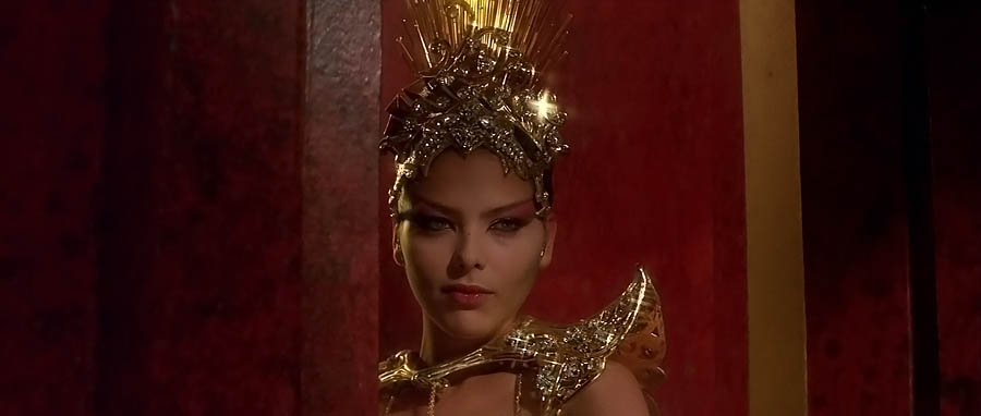

Premium Member David Mullen ASC Posted July 18, 2016 Author Premium Member Posted July 18, 2016 Looking at some other movies shot with nets... most people know about Gil Taylor using nets in the Tatooine scenes in "Star Wars", where it might have worked better had they not run into such overcast weather on location, but after that, Taylor shot "Flash Gordon" and "Dracula" extensively with nets and I think both movies look quite nice. In "Flash Gordon" it worked particularly well because of all of the reflective costumes, and for "Dracula" it created a romantic tone. One thing I have noticed in a number of films are scenes where the nets are pulled probably because of some flaring problem, often replaced with some other diffusion -- in the case of "Flash Gordon" and "Dracula", it looks like a fog filter replaced the net now and then. In two different scenes in "Dracula", once when Lawrence Olivier is climbing into a grave that leads to a tunnel, and another when he is entering the castle, carrying a lantern in both cases, on one side of the entrance, there is a fog filter, but when he enters the next space, it switches to a net. This is one of the scenes where the filter changes once they go through the door:

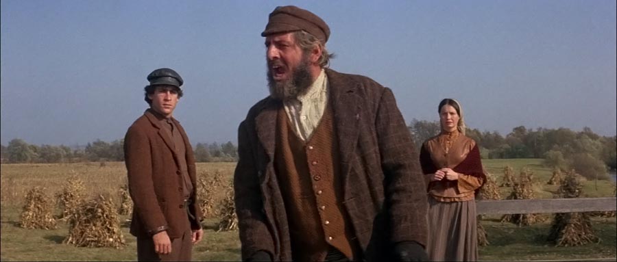

Premium Member David Mullen ASC Posted July 18, 2016 Author Premium Member Posted July 18, 2016 Looking again at the blu-ray of "Fiddler on the Roof", it's interesting to me how subtle the brown pantyhose net filtration is. Part of the reason I think is that there are rarely any bright lights or the sun pointed into the lens, and the slowness of the film stock meant that even indoors there weren't too many hot windows to flare the filter. Ozzie Morris must have had the netting stretched as wide as it could go to keep the effect lower. You can see here that even in backlight, the net doesn't create much halation, maybe because the sun was softer, hazier in Yugoslavia where they shot the movie: In the barn scenes the hot gaps in the roof flare just a little but some of that could also be the lens optics more than the net: Since much of the film was shot with an anamorphic zoom, which was f/4-5.6 at the widest, some day scenes at the wide-angle end can sometimes have a faint chainlink fence artifact in the blue skies from having too much depth of field and seeing the net start to come into focus: The artifact is easier to see in motion as the camera pans around than in a still frame.

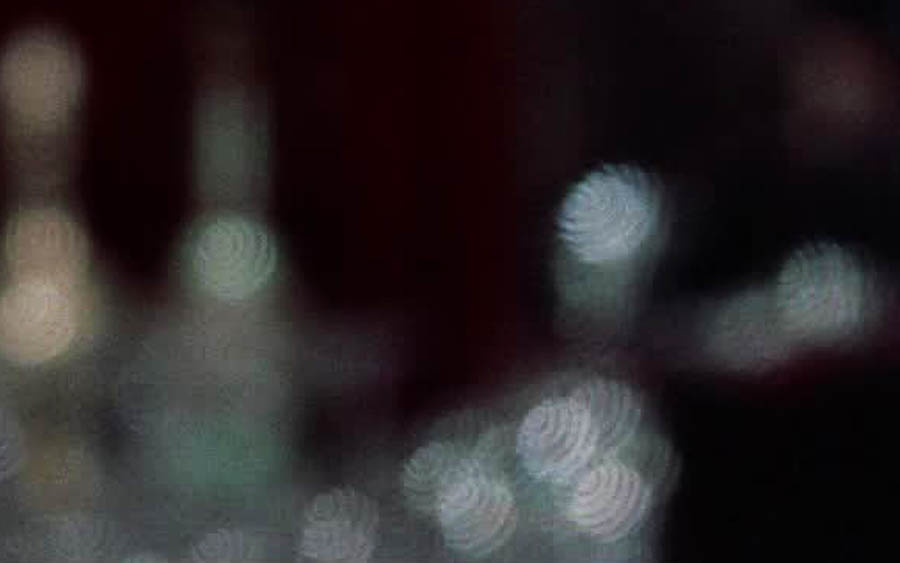

Premium Member David Mullen ASC Posted July 19, 2016 Author Premium Member Posted July 19, 2016 A lot of that blue-ish halo effect in Hamilton's photos come from fog filters though I'm sure he also used nets. Another popular diffusion in the 30's through 50's was a glass filter with concentric rings etched in it, sometimes called "dutos" in Europe because a version was made and used by a Hungarian photographers Jeno Dulovits and Mikos Toth. In the bokeh, you see a thumbprint type pattern of partial rings -- I've posted frames before from "Spellbound" and "Vertigo" showing the artifact.
Premium Member David Mullen ASC Posted July 19, 2016 Author Premium Member Posted July 19, 2016 Enlarged section showing the ring pattern from the concentric ring diffusion filter:
