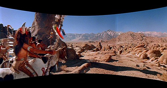

stephen lamb Posted September 21, 2008 Posted September 21, 2008 After reading this thread I decided to check out How the West was Won. Pretty cool film I'd have to say. I found some segments of the film fantastic, and other perhaps a bit slow. I loved the music, and I loved how the music tied it all together. As for the Cinerama, i think what I loved most about it was how they were able to capture such wide angle shots without the barreling distortion. They did a great job of composing many of the static shots so that perhaps at the beginning of the shot, there seemed to be some dead space, but by the end of the shot, the character(s) action(s) had filled up the space. The lines that seperrated the three frames were quite visible on my copy of the DVD, but I think it is an old one, I got it from the town library. With today's DI technology, it would be pretty cool to see something like this be tested again, just to be able to get those super wide shots, sans barrel distortion. Maybe not even for a whole film, but just for certain shots. I think my favorite shots were of the Indian horse charge, and the camera tracking alongside, and also of the train heist, with the oncoming train growing larger and larger getting close enough that the 27mm lenses distorted it alot, making it look extra menacing. Anywho, very cool to see this, before the thread, I had never heard of Cinerama, so thanks for posting about it.
Guest Glen Alexander Posted September 21, 2008 Posted September 21, 2008 This is Alabama Hills in Lone Pine, CA. I got that beat with a Nikon 14mm F2.8 lens on a Vistavision camera in Death Valley.
