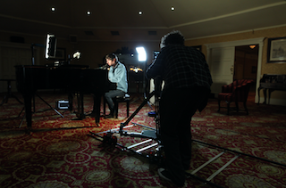

David Daniel Doherty Posted March 4, 2018 Posted March 4, 2018 (edited) Hi all, Im shooting a live piano performance in the attached room. (Excuse horrible image) At my disposal I have a couple of 1x1 LED Litepanels, day light to tungsten. The music is dreamy and melancholic, my client would like dramatic, contrasty, low key lighting. We would like to use some color to influence the melancholic mood. Perhaps a hint of blue in the backlighting, which may or may not be motivated moon light. We are shooting at night, the shots will range from close up to wide angle. Id love to hear how you would approach this, with the gear listed? (Ive some decent tungstens too, but hope to only use the litepanels) Cheers, David Edited March 4, 2018 by David Daniel Doherty
Premium Member Mark Kenfield Posted March 4, 2018 Premium Member Posted March 4, 2018 (edited) By 'a couple' of 1x1 panels. Do you mean literally two of them? And what tungsten fixtures do you have access to? Edited March 4, 2018 by Mark Kenfield
Premium Member Phil Rhodes Posted March 4, 2018 Premium Member Posted March 4, 2018 And how much power is there?
David Daniel Doherty Posted March 4, 2018 Author Posted March 4, 2018 Hello, I have literally two of these http://www.litepanels.com/en-US/Shop/products/led-lights-astra-1x1-ep-bicolor And 3 x 800w Arri Tungstens
Premium Member Mark Kenfield Posted March 4, 2018 Premium Member Posted March 4, 2018 Okay, how wide do need to be able frame the scene? As wide as that photograph of the piano?
David Daniel Doherty Posted March 4, 2018 Author Posted March 4, 2018 That would be nice, although in theory the key light should be pretty close, so I’ll have to experiment on the day and find a good balance. Probably not that wide though

David Daniel Doherty Posted March 29, 2018 Author Posted March 29, 2018 (edited) He sorts the audio, and doesn't have unlimited choice in gear. It sounds great I reckon. Ha, I didn't notice that green tape, but yeah. It was an overwhelming shoot, being solo, so it was well down the priority list. Next time! Here's the set up: Edited March 29, 2018 by David Daniel Doherty
