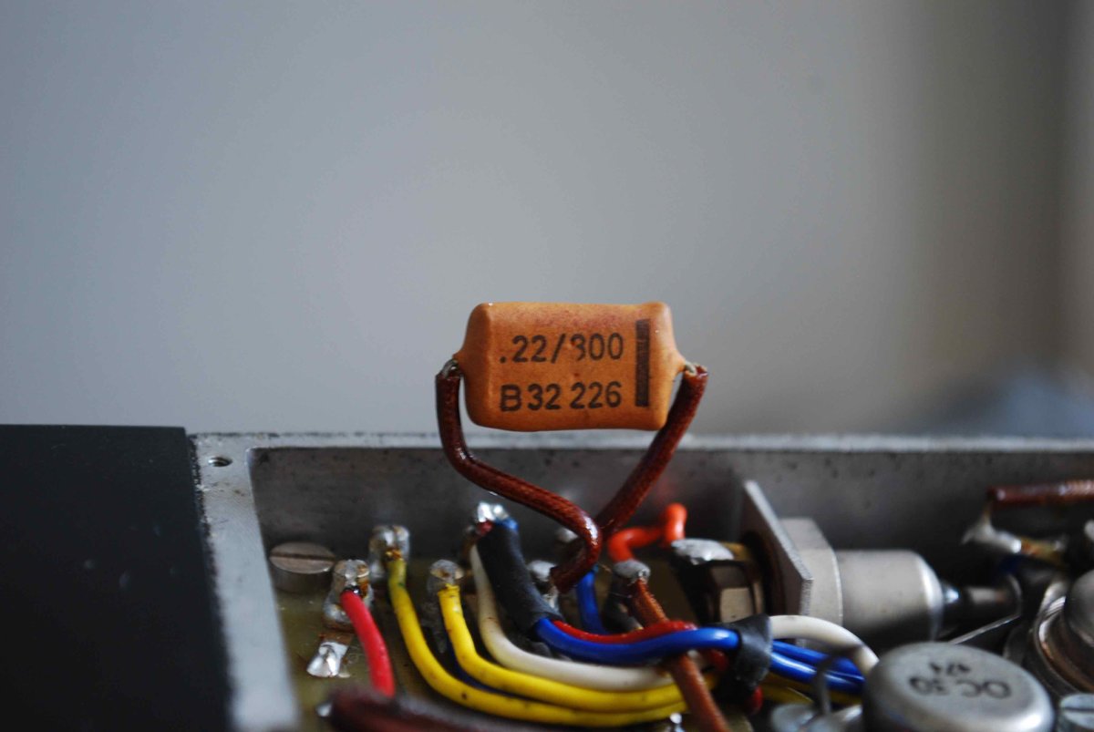

Marek Budzynski Posted July 23, 2020 Posted July 23, 2020 Aapo, Sorry to bother you but I think you may be able to help me? I managed to get one the motors running that I go from eBay. I think I've identified it as a 12vdc Perfectone that runs at a constant speed. It has a synch pulse output which I think is similar to the some of the NPR motors. Not sure how fast it runs yet. However I got it running by accident when I by passed what I think is a capacitor. It's marked up as .22/300 B32 226. I think it's a Siemens. Could you suggest a replacement as I have no idea where to begin or how to identify what spec it is? Cheers Marek
Friedemann Wachsmuth Posted July 23, 2020 Posted July 23, 2020 That's a 220nF / 300V cap. It is not supposed to let any DC through though, so probably not broken.
Marek Budzynski Posted July 23, 2020 Posted July 23, 2020 That's interesting. When I bypassed it the motor started running? What's it used for?
Friedemann Wachsmuth Posted July 24, 2020 Posted July 24, 2020 Hard to say without seeing more of the schematics. It's a bit too big for a snubber. When you said "bypass", do you mean bridging it or taking it out?
