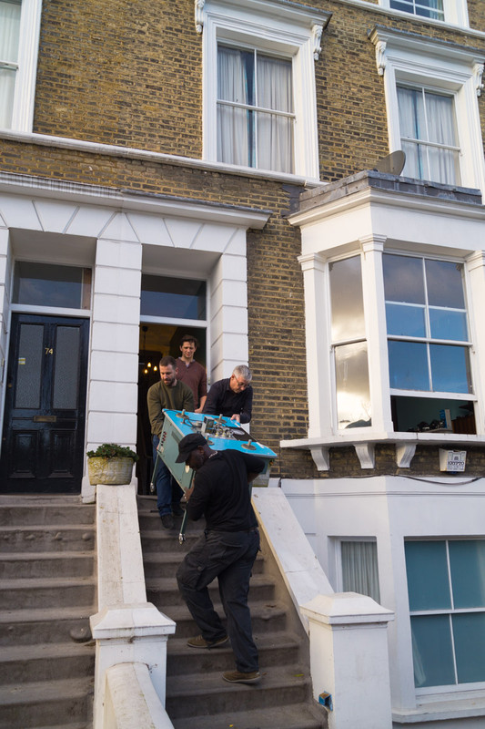

Mark Dunn Posted September 7, 2022 Posted September 7, 2022 (edited) 15 hours ago, Robert Hart said: The mid strapping of the machine into the corner of the van looks good to me. The only extra I would do would be add a strap through the legs under the chin of the metal casework up to the next higher rail in the van. I would agree with the larger machine with the furniture legs.. What the pix don't show it that the 1600 has box section legs which angle forwards so it would resist popping out. I should add that the prop master's van may have uprated suspension to keep the lurching to a minimum, which OP probably won't have. But then American vehicles are as soft as jelly compared with ours ;) When in the back of the car the legs come off (not an option for OP's model) and it sits strapped down on the motorcycle ramp supported by a wooden box. That's for short distances in town though. I charge a lot for delivery because I don't really want to do it.☺️ Edited September 7, 2022 by Mark Dunn 1

Mark Dunn Posted September 9, 2022 Posted September 9, 2022 (edited) Well Cutfilm's lowest listed price for a 6-plate is $4000- has he valued it for you separately? https://cutfilm.com/used.html so watch out for that. You are certainly going to need assistance even to push it through a doorway- chances are the castors will be very tired. And we've probably said this before but it's worth repeating- don't lift the tabletop, only the case. The good news is Steenbeck are very robust, but it's also the bad news as most of that hardware is solid steel. The machine probably won't have travelled as far as you're taking it since it came off the plane in about 1965 (I took one on an 1100-mile round trip a while back and that was quite a show) so we would all like an update. Good luck. Edited September 9, 2022 by Mark Dunn

Site Sponsor Perry Paolantonio Posted December 9, 2022 Site Sponsor Posted December 9, 2022 On 9/6/2022 at 12:47 PM, Mark Dunn said: Last time I had mine shipped as a practical prop they sent a big van with a tail lift and a man with lots of foam and straps. You probably haven't got one of those. Dwight Cody helped me move mine back in the 90s from one apartment to another. I learned about how to take it apart and move it down three twisty flights of stairs that day - things I wish I had known previously! By the time I moved out of my last place, I owned a 1971 VW camper van. I considered dismantling the Steenbeck as Dwight showed had me on the previous move, but on a hunch we slid the side door open and lo and behold, it was like that van was designed to move flatbed editors. Four people to lift it and it slipped right in. Fit like a glove.
Mark Dunn Posted December 10, 2022 Posted December 10, 2022 (edited) 15 hours ago, Perry Paolantonio said: Dwight Cody helped me move mine back in the 90s from one apartment to another. I learned about how to take it apart and move it down three twisty flights of stairs that day - things I wish I had known previously! By the time I moved out of my last place, I owned a 1971 VW camper van. I considered dismantling the Steenbeck as Dwight showed had me on the previous move, but on a hunch we slid the side door open and lo and behold, it was like that van was designed to move flatbed editors. Four people to lift it and it slipped right in. Fit like a glove. Well, I now have a pair of motorcycle ramps, bought by a show I worked on, with L-shaped storage rack supports as rails bolted on, and some great 3-inch double castor wheels. So I can get it in our large hatchback, legs off, but I prefer a small van rented by the show. The way I make this happen is by charging a lot for delivery. So the last two shows have sent a big prop van (big by European standards- search "luton van" because they used to be made in Luton, Bedfordshire -it's become a generic term). But as you say the best way is really four strong grips who'll just grab it by the legs and carry it up and down steps. Like this. Still had to get it out of the car ourselves back home, though. Edited December 10, 2022 by Mark Dunn
