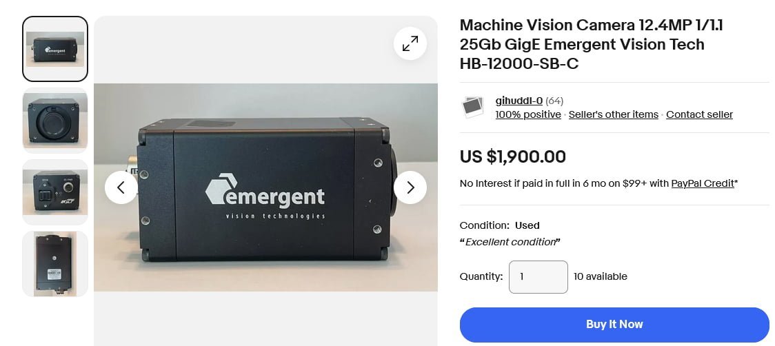

Dan Baxter Posted June 10, 2024 Posted June 10, 2024 On 6/4/2024 at 3:28 PM, Tyler Purcell said: Camera alone is gonna cost $5k. The scanner manufacturers buy them wholesale not retail. 😛 But if you're building your own scanner from scratch, here 'ya go: 4K and same brand that LG uses. Or, Teledyne Flir $1,800 brand new retail price. As I mentioned to Mr Teoli we all know what components go into a modern digital movie film scanner, it's hardly a secret and the designs are relatively simple requiring less in the way of complex engineering. The being said, they require engineering - they require maintenance, they require software development, they require technical support for the users. People don't seem to appreciate the amount of R&D that goes into these devices. It took Blackmagic about 4 years to bring their Cintel scanner to market, and ever since then the pace of development has been glacial. They bought-out Rank Cintel so they started with industry knowledge and existing IP. Obviously they haven't just gone and used a Rank Cintel telecine transport module - but every part of it became Blackmagic's knowledge: film tensioning, roller/sproket designs, gate designs, etc. 2024, that's 8 years, is when they released a dual 8mm gate for them - and of course it will only work on the capstan model Cintels not the older pre-pandemic models that are sproket-driven. What surprises me is that people are saying the Filmfabriek Pictor is too expensive. If that's the case what's stopping someone from buying something cheaper? Here's a Super-8 sound "transferkit" used by a Spanish university: They only cost €2,000-€3,000 each and the kinds of users that would buy them are most likely replacing older projector-based 8mm/16mm transfer systems including filming the projection off a wall, Tobins, or Moviestuff equipment or even DIY equipment. Is it perfect? Of course not. Is it as good as a Pictor? No. To make them at that price compromises are made, and similarly compromises are made for usability. On 6/6/2024 at 2:10 PM, Tyler Purcell said: So really it's just down to a bandwidth issue in terms of speed. Did anyone make something faster or was it just lower res? Yes they did, the line-sensor CCDs are single-tap and speedy. Given the engineering costs involved in making line-sensor scanners as well as the other downsides, I don't see the point now.
Premium Member Tyler Purcell Posted June 10, 2024 Premium Member Posted June 10, 2024 11 hours ago, Dan Baxter said: The scanner manufacturers buy them wholesale not retail. 😛 But if you're building your own scanner from scratch, here 'ya go: Interesting, yea I mean the camera we've been wanting to upgrade our scanner is $3500 USD. I think it's because the imager is physically larger than the cheaper cameras and for a reason; better dynamic range with larger pixels. I guess if the quality doesn't matter, then it doesn't matter.
