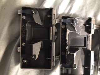

Boris bruno Posted August 22, 2020 Author Posted August 22, 2020 Thank you so much to all you guys. This was very helpful. So pretty much I have an arri 2c with bncr mount a few gates, I’ll send pictures. I will upload a picture of what I have

Premium Member Dom Jaeger Posted August 25, 2020 Premium Member Posted August 25, 2020 22 hours ago, Boris bruno said: That's a lot of gates! Can you post photos of them closer up with the pressure plates open so we can see what the cut out aspect ratios are? What do the labels say? Is there another one fitted to the camera? And to echo Satsuki, what framelines are on the the ground glass? 1
Boris bruno Posted August 25, 2020 Author Posted August 25, 2020 7 hours ago, Dom Jaeger said: That's a lot of gates! Can you post photos of them closer up with the pressure plates open so we can see what the cut out aspect ratios are? What do the labels say? Is there another one fitted to the camera? And to echo Satsuki, what framelines are on the the ground glass? I will
Jon O'Brien Posted August 29, 2020 Posted August 29, 2020 Well, none of them look like Scope (1.2:1). It's difficult for me to see as it's in the shade but one of the gates looks a bit like 1.85:1 or thereabouts, which I find unusual. I presumed the usual practice when shooting 4 perf spherical was to shoot 'full' academy frame and crop to 1.85 either in the print making process or in the projector. Or maybe I'm just not seeing it well enough in the picture. Or is it a 2-perf gate (I'm referring to the bottom RH gate)? Doesn't seem quite to be 2.40:1. What do the labels say?
Premium Member Dom Jaeger Posted August 29, 2020 Premium Member Posted August 29, 2020 Looks like 1.66:1, 1.85:1, the standard Academy gate of 1.37:1 and maybe 1.33:1 (or another Academy gate), but knowing what the labels say would be helpful. There's no 1.20:1 Scope gate as far as I can tell. 1.85 was pretty standard for cinema release. Masking at the camera gate rather than during printing or projection or transfer was more common before the 90s. These days you could just use the full Academy gate and extract the desired aspect ratio during post, but for composition/framing the ground glass framelines are what matter. It's possible the ground glass is a combo. It can be removed to properly measure it, OP can check the manual instructions if unsure how to do that. 1
