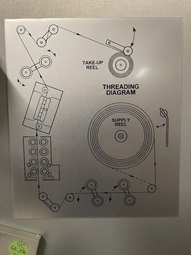

Site Sponsor Robert Houllahan Posted January 14, 2022 Site Sponsor Posted January 14, 2022 Here are a few more of the XL1100 and how the buffers and film path work:
