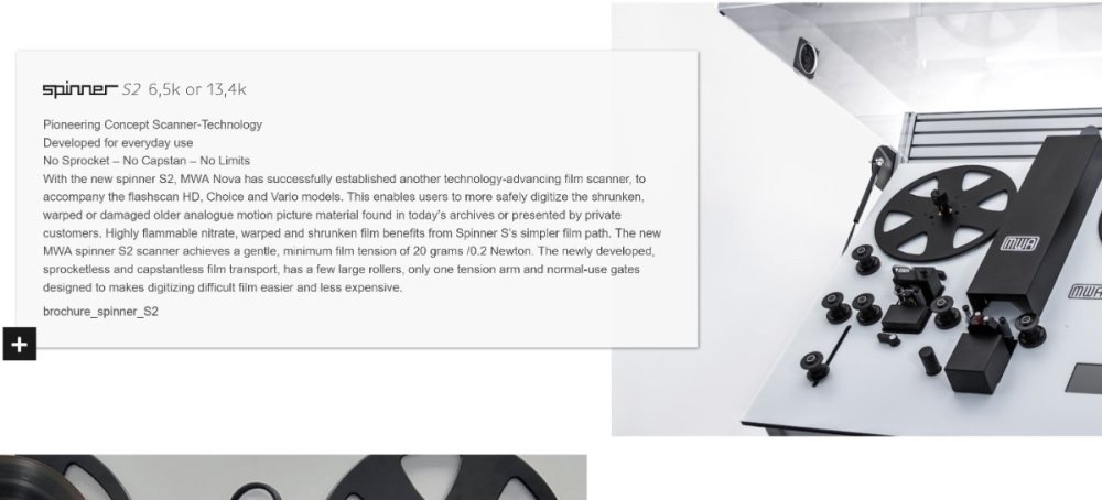

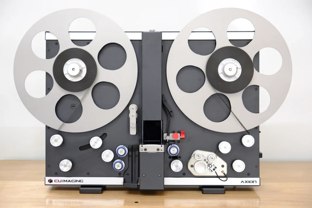

Daniel D. Teoli Jr. Posted January 12 Author Share Posted January 12 On 1/9/2024 at 1:08 AM, Tyler Purcell said: I mean, has there been in the last decade? Not really. Scanners have been scanners for awhile. Laser Graphics dominates the mid tier. They make THE BEST machine for the money, period. DFT and Arri dominate the upper tier. Outside of resolution, none of their machines have changed much in years. The lower tier like BMD and Film Fabriek, nothing new there. BMD will require an entirely new design to use a new imager, so that being the only "negative" about the BMD scanner and unfortunately makes it not a very good machine to boot, means there isn't any real developments on that front. They will not be making something new anytime soon sadly. Film Fabriek may have a prototype of their new machine by NAB, but doubtful it will be ready for production. I also don't think it will be game changing, probably just fixing the issues of the old machine. So no, nothing new really. I will say for the record, I'm pretty chuffed we were able to scan this destroyed film that was literally tearing itself to pieces as it came off the roll. We took a slab, put it between two blocks to get it flat and measure it, which was 15mm wide and the frame size was down by half a mm. It had shrunk THAT much. Emulsion was flaking off in our hands as we worked with it and it was so brittle, it would tear sneezing on it. However, with low-tension mode, a clever little gate I developed with PTFE clamping material and our wet gate, plus two layers of digital restoration, it's now a watchable product. Mind the audio, we did make a mistake on this demo sample that I haven't fixed yet. Before: AFTER: Thanks for the rundown Tyler! Did BMD lose interest in their scanners? Their price point is good. Couldn't they just upgrade the imager or is the whole machine a mess? Impressive work you did to get the scan on that film. Was the sound done with the Film Fabriek optical reader? I remember you said it had problems with sound. Link to comment Share on other sites More sharing options...
