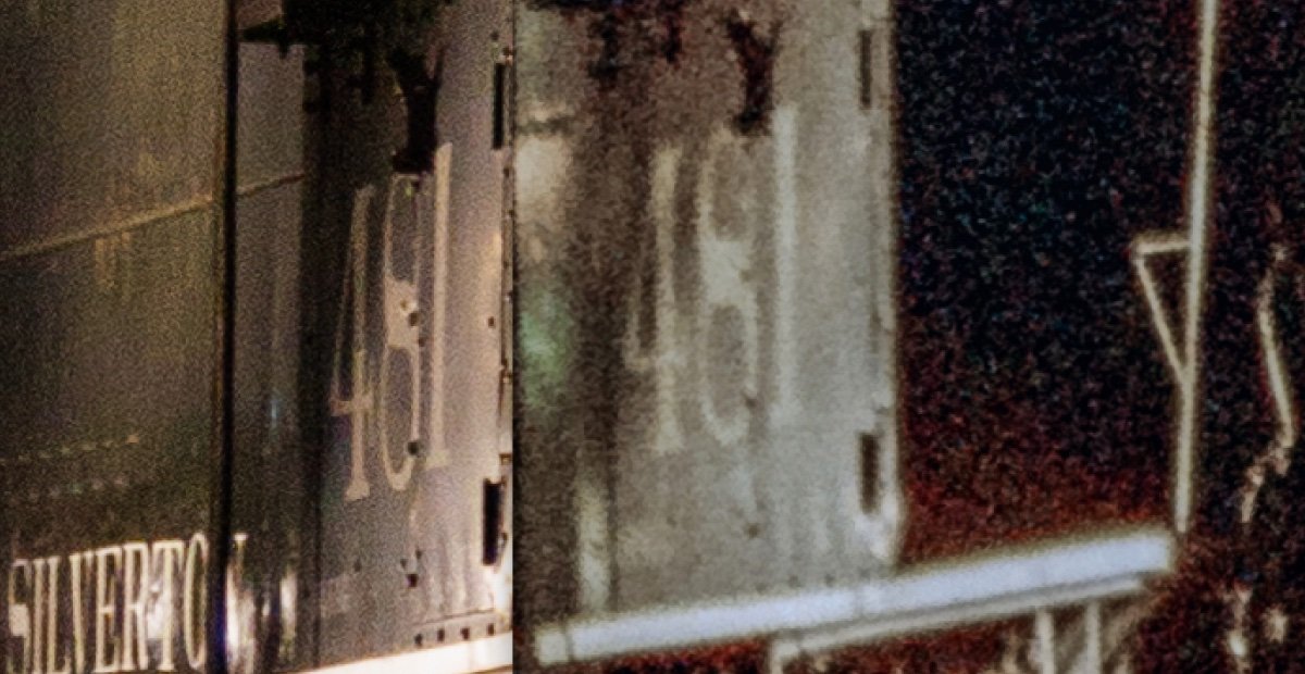

For the record, here is by far the most difficult thing for film to do.
R5 8k (28MP) at 800 ISO and Gold 800 35mm film scanned at 6k (18MP). Sadly, two different lenses. The R5 was a 24-105 RF and the 35mm was a 24-70 EF. However, you can clearly see the R5 is a winner in the res department, but at 5x zoom, the only thing holding back the film is the grain.

Either the R5 isn't that good or Gold 800 is better than I thought! Of course, film is getting stupidly expensive these days, but it depends on what emulsion and where you buy it. Some labs have pre-paid processing and scanning with the films they sell, so that's one way of not spending $2 per shot.
Yea canon doesn't have the noise reduction tech that Sony does. So it'll always be more noisy. It's also running an F4 lens vs an F2.8 lens. So it's running a stop behind. I could have gotten the grain down on the R5 by doing a longer exposure, but seeing as we mostly shoot things in motion, we kept the shutter speed higher, like 1/60th or something in that realm on both cameras.
800 is pretty good honesty, it's the first time I had ever shot with it.
Yeah 35mm still film is crazy these days, it's an added expense that seems hardly worth it. At least 16mm has a very different look than 35mm.
