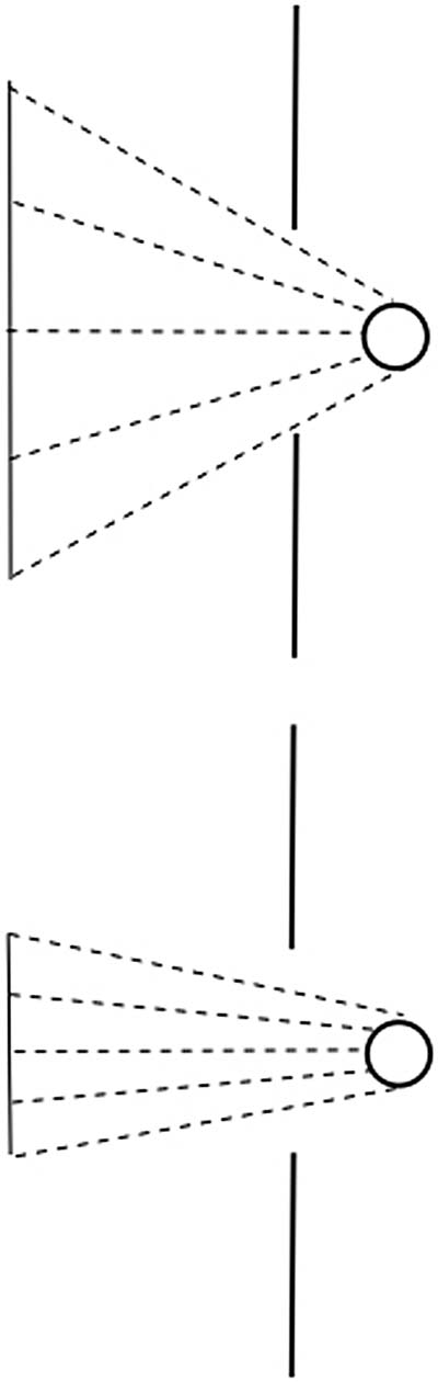

Premium Member David Mullen ASC Posted December 10, 2015 Premium Member Posted December 10, 2015 Question Matt. Why not just use a smaller diffusion since you arent really using the entire diffusion as shown. Wouldnt that be easier? Wouldnt you still get the same result? Don't you think the "wouldn't it be easier?" question is in reference to the large amount of flagging? He's assuming from the animation that the flagging is cutting down the size of the diffusion area but that's because he isn't noticing the space between the diffusion and the flags. Again, you have to think three dimensionally. If the subject standing there can see more of the diffusion frame behind the flags from their position, then it means they are receiving a larger area of light than the shape of the square hole in the flags, and therefore the light is softer than the size of that gap in the flags. If you shrank the size of the diffusion and the subject could see that the diffusion frame was smaller from their position, then they would be less softly lit because the size of the source would be smaller. The animation is confusing because it is a 3D animation presented in 2D from one angle. As I said, if he created an overhead view with software that simulates the spread of light, you'd see that the larger source is still hitting the subject from a wider range of directions and therefore is a softer source.
Premium Member David Mullen ASC Posted December 10, 2015 Premium Member Posted December 10, 2015 Here's a crude drawing of swapping out the large diffusion frame behind the gap between two flags with a smaller diffusion frame: As you can see the subject from their perspective can see more of the large diffusion frame behind the flags and therefore is receiving light from more directions, thus getting a softer light on their face. 1 1
Premium Member Gregg MacPherson Posted December 10, 2015 Premium Member Posted December 10, 2015 I think "easier" refers to downscaling everything. But, no reasonable person would automatically remove the flags, so that line of thinking is not so interesting. As you say, there is a small band of diffussion screen hidden by the flags that contributes something to the subject. For her face the band is like 8'' wide at the top and 6'' wide at the bottom. So, if one was fussy and thinking three dimensionally, just size the smaller diffussion frame to that. Or consider the value of that contribution and perhaps ignore it. The fun in a teacup diversion was about whether one could get the same look with a smaller diffusion frame and smaller source. Sorry to Matt if he's dissapointed in that spinoff.
Premium Member David Mullen ASC Posted December 10, 2015 Premium Member Posted December 10, 2015 I don't see why just making everything a little bit smaller is less work, it's the same number of stands, flags, and diffusion frames. You could make it significantly smaller to make it easier but then it's not the same effect. To get the same softness you'd have to move everything closer to the subject, and then you'd have a greater fall off in intensity with distance from the source.
Premium Member Gregg MacPherson Posted December 10, 2015 Premium Member Posted December 10, 2015 Our last post crossed in the ether. Your flags in the drawing are a long way away from the diffusion frame, which illustrates your idea very well. But in Matt's simulation, the top and bottom flags are a bit over 2' from the diffusion screen. Left flag front edge similar? OK the right hand flag front edge is 5 or 6'. So your drawing illustrates a principal, but not how that principal is applicable to this set, setup. Actualy it's missleading. As I said before, the hidden band on the big diffusion screen at the top and bottom is quite narrow. Looks to me like the smaller frame would be about half the size so the lamp would be about 1/4 the size. That's not "a bit" smaller.
Robin R Probyn Posted December 10, 2015 Posted December 10, 2015 But no getting away from the physics .. if its all smaller.. maybe even you could get a short gaffer.. you will have to move it all closer to the subject to get the same softness of light.. which effects your wide shot.. and how much the subject can move around.. so its not the same setup..
