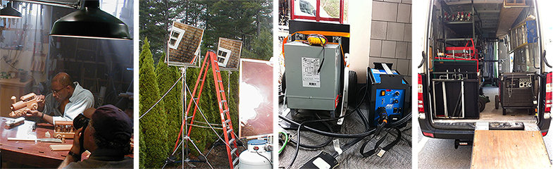

Guy Holt Posted November 20, 2018 Author Posted November 20, 2018 Time to get back to the original purpose of this thread: to share the tricks of the trade that will add more to your film’s production values than all the big budget toys found on bloated Hollywood productions. If you can’t afford a generator, no one tool in your indie bag of tricks will improve the lighting of your film more than a live wire circuit tracer. One of the biggest hurdles to obtaining good production values in low budget digital cinema productions is the high cost of the blimped studio generators required to power large lighting packages. Not only are blimped generators expensive to rent, but they also come with hidden costs. Since rental trucks like those from Ryder or Penske are not equipped to tow, you quite often have to pay extra to have them delivered or hire the rental house's grip truck to tow them. And, since most rental houses require that one of their employees drive their trucks and operate the generator (for insurance reasons), the production has to hire a driver/genny op at roughly $575/10hrs - which is probably more than anyone else on a typical indie crew is getting paid. All of this makes lighting a movie very expensive. More likely than not you don’t need a generator. Most locations have plenty of power, you just need to know where to find it. The first step is to determine the maximum the location electrical service has to offer. To determine this look at the main breaker of the service head (main electrical panel.) Commercial wiring is almost always three phase, meaning it has three hot legs. If the breaker in the main service panel is 200A there are 600A available between the three hot legs. The second step is to figure out how much power the location is using, so that you know what is left over for your use. To determine this find somewhere safe to meter the current drawn on each leg with an Amp probe. Once you know what is available to you, use a live wire circuit tracer to figure out what outlets correspond to which circuits so that you can safely distribute your lighting load without overloading a circuit. Before we get into how to use a live wire circuit tracer, let’s first look at residential wiring. Residential wiring is almost always single phase, meaning it has just two hot legs. If the breaker in the main service panel is 100A there are 200A available between the two hot legs. Again, you need to figure out how much power the location is using, so that you know what is left over for your use. There may be some large loads, like air conditioners or electric ranges, that you can turn off at their breaker to make more power available to you. So that you don’t overload a circuit, the final step is to use a live wire circuit tracer to figure out what receptacles correspond to which circuits. I recommend the Scotchtrak Circuit Tracer. It will enable you to locate, trace and identify ‘‘hot’’ and neutral wires for feeder and branch circuit wiring, breakers, and outlets. Most circuit tracers require that you de-energize the distribution system. What I particularly like about the Scotchtrak Circuit Tracer is that it enables you to trace the circuits of an energized system. The tracer consists of a transmitter that draws a pulse current from the line that is returned on the neutral, and a detector that senses the unique electromagnetic field around the line created by the pulse current. Scotchtrak circuit tracers are easy to use. First, plug-in the transmitter to the circuit you want to trace. Then hold the detector to a breaker, cable, or outlet. If it is the same circuit, the detector will sense the unique electromagnetic field and emit both a visible and an audible signal. By tracing the magnetic field in this fashion you can locate the breaker, wires, and outlets that correspond to that circuit. As you can see by the wiring diagram for an apartment below, a circuit may supply power to outlets in more than one room. Now that you know what outlets correspond to which circuitw you can now safely distribute your lighting load over the house distribution system without overloading a circuit and tripping its’ breaker. Of course you may have to run cable a distance to find additional circuits so be sure to have plenty of stingers available. Use this link for more information on the Scotchtrak Circuit Tracer. To power larger fixtures, like 5k Tungsten or 4K HMI lights, you can use a step-down transformer to convert the power from 208V/240V receptacles to a single large 120V circuit. Most locations will 208V/240V circuits to power motors, machinery, compressors, pumps, electric ranges, electric dryers, and special receptacles installed for Window Air Conditioners. If you look at the breaker for any of these 208V240V receptacles, you will notice that they use two pole breakers - either 30A or 50A. Each pole of the breaker is in a sense an independent 30A or 50A 120V circuit. That is, if you measure the voltage from each pole of the breaker to ground it will be 120 volts, and if you measure the voltage between the two poles of the breaker you will notice that it is 208v or 240 volts (depending on whether the building provides three phase or single phase power respectively). If your location has a single phase service, the 120 volts of the two poles adds up to 240V because the 120V circuits are on opposing legs that are180 degrees out of phase with each other. In residential settings, this is how higher voltages are supplied to household appliances, like Dryers, Electric Ranges, Water Pumps, and Air Conditioners, that require more power than can be reasonably supplied by a single 120V circuit. If your location has a three phase service, the 120 volts of the two poles adds up to 208V because the three 120V circuits are on opposing legs of a three phase service and therefore 120 degrees out of phase with each other. 4k & 1.2ks HMI Pars powered from 30A/240V dryer outlet through step-down transformer/distro for Bose still shoot. A step down transformer, like the one we build for the Honda EU7000is Generator, can convert the 208V/240V supplied by these receptacles to 120 volts in a single circuit that is the sum of two of the phase legs of 30/50 amps each. Now that you have a larger 60A or 100A 120V circuit, you can operate larger lights, or more smaller lights, than you could otherwise. If you outfit the transformer with a bates receptacle you can use standard film style distro like 60 or 100A Bates Extensions to run power around your set - breaking out to 20A circuits wherever you want. By giving you access to more house power through common 208V/240V outlets a transformer can eliminate the need for dangerous tie-ins or expensive tow generators (use this link for details.) Guy Holt, Gaffer, ScreenLight & Grip, Lightng & Grip Rental in Boston 1
