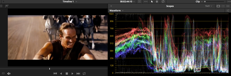

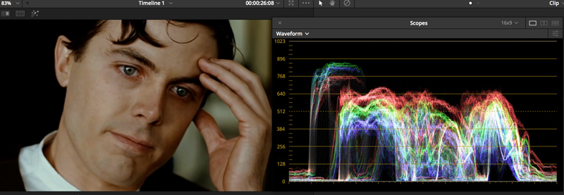

Richard Swearinger Posted August 14, 2017 Posted August 14, 2017 Do clean waveforms equal better shots? I was looking at the waveforms of a few different great films and they all shared something. The waveforms were very clean looking and usually surrounded by big areas of black—completely unlike mine which typically look like RGB shredded wheat. Attached are examples from Roger's The Assassination of Jesse James and Ben-Hur. Of course there are no shortcuts around careful composition, elegant lighting, and proper exposure, but am I crazy to think that uncluttered, organized-looking waveform patterns might also be an indicator that the image is on the right track visually?

Mei Lewis Posted August 14, 2017 Posted August 14, 2017 I really think there's something in this. I don't think cinematographers are using waveforms to judge composition, or even very much to judge about lighting, other than exposure levels. But by 'measuring' the images with a waveform monitor, some of their structure makes itself apparent. (That's true if we're looking at images from the camera or final shots as they appear in the film). The waveform is showing something about the geometry of an image, and often images that people like from a cinematography standpoint are very clear and simple, the viewer knows exactly how to interpret what's going on. Look at this list: https://www.buzzfeed.com/danieldalton/there-will-be-scrolling?utm_term=.umdYd0gv5#.drmeVqQmp (I'm not saying I agree with the list, but they are the sort of shots many people like). Most of them are very simple and could be sketched without too many pencil lines.

AJ Young Posted August 15, 2017 Posted August 15, 2017 Instead of comparing waveforms, compare your images to his. Start asking why you like his specific frame? Is it the quality of light? The color? Composition? A waveform, histogram, vectorscope, and so on are just tools to figure out exposure and color. They will never tell you WHY a decision was made.
