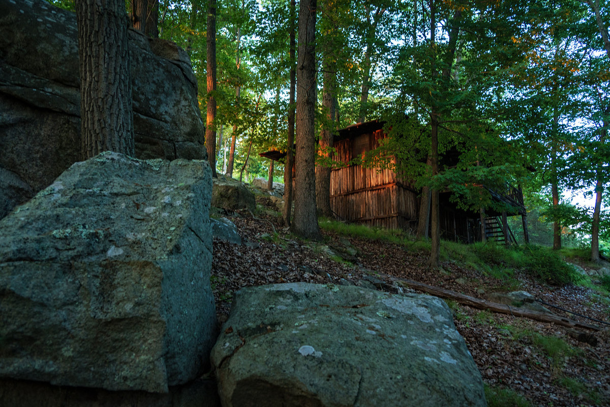

Premium Member David Mullen ASC Posted April 30, 2019 Premium Member Share Posted April 30, 2019 Here are the last rays of sun hitting an old cabin in the woods — again, warm sun, cold shadows: Quote Link to comment Share on other sites More sharing options...
