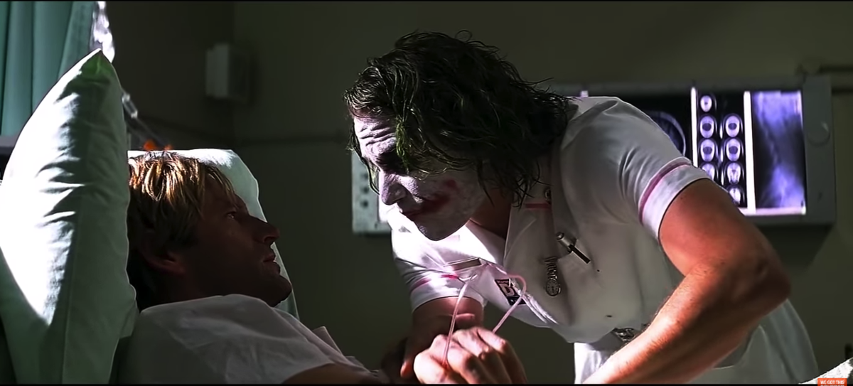

Premium Member Justin Hayward Posted January 1, 2020 Premium Member Share Posted January 1, 2020 I stop and watch "The Dark Knight" pretty much every time it pops up on TV (it's one of those movies for me) and it popped up today while I was cleaning the kid's play-do off the floor. These screen grabs were pulled off youtube, so they're not a good representation of the actual shots, but I feel like Wally Phister has a fantastic take on how to light and expose for simulated sunlight in my opinion. I've been simulating sunlight on many shoots for the better part of 20 years (and just recently on another commercial), but I've never felt I've gotten it to feel this authentic. Again, these stills are misleading, because the movie is not this contrasty (the ratios aren't this drastic), but I think you can imagine what Wally Phister does with sunlight in general with these frames. What are some of the ways you all have simulated sunlight and what do you feel are the most effective overall? Thanks! 1 Quote Link to comment Share on other sites More sharing options...
timHealy Posted January 1, 2020 Share Posted January 1, 2020 I would say every window has at least 1-18k fresnel through it on a lift. If Janusz shot it there would be at least 2-18ks fresnels i each window. I do like Phisters work. in the dark night movies, usually one backlight and a fill light that acts as an eyelight. that's it. very simple and beautiful. Tim Quote Link to comment Share on other sites More sharing options...
Premium Member Justin Hayward Posted January 1, 2020 Author Premium Member Share Posted January 1, 2020 52 minutes ago, timHealy said: usually one backlight and a fill light that acts as an eyelight. that's it. very simple and beautiful. Yes, that's a great way to put it. It is, of course, not simple in execution, but so simple in authenticity. Quote Link to comment Share on other sites More sharing options...
Stuart Brereton Posted January 1, 2020 Share Posted January 1, 2020 I think a big part of the ‘realness’ comes from using large sources backed off from the windows. It’s a lot harder to make convincing sunlight when you are forced to use smaller lamps in close proximity. The fall off never looks right, and the shadows aren’t parallel. 2 2 Quote Link to comment Share on other sites More sharing options...
Stuart Brereton Posted January 1, 2020 Share Posted January 1, 2020 Another thing which I think helps greatly to sell a sunlight effect is making sure that whatever fill you use is coming from an appropriate angle. If the sun is hitting the floor, or low down on a wall, having the fill come from a similar angle will look a lot more realistic than filling from a perfect 45º angle. In terms of exposure, in real sun there is usually about 3 stops difference between metering towards the sun and away from the sun. With a backlit actor, I would usually split the difference so that their face is 1.5 stops under, and the sun on the back of their head is 1.5 over. That's roughly where I would choose to expose simulated sun as well, as long as it's not a front lit scene. 3 Quote Link to comment Share on other sites More sharing options...
Premium Member Justin Hayward Posted January 1, 2020 Author Premium Member Share Posted January 1, 2020 All good points. Big lamps, far away are a must, but I never thought of the angle of the fill in the room. Interesting. After looking back at this I think what strikes me about the sun lighting in this movie is it's often almost coming from the angle of a key light, which is so rare. In that last frame, the sun is hitting Heath Ledger's face directly. Interior sunlight in movies (and exterior for that matter) is almost always a backlight or raking walls or whatever. If it ever hits someone directly, it's usually flagged off their head and shoulders, so hard light is only hitting their body. Obviously I understand why this is done, but I wonder if that's why the sun lighting in this movie feels more real to me... because it's unusual to see in a film? Quote Link to comment Share on other sites More sharing options...
timHealy Posted January 2, 2020 Share Posted January 2, 2020 The sun effect is hitting Health ledgers face but it is more of a side light, slightly back lit. Not quite a 3/4 back. I think that is usually just fine. I think where you see the sun flagged off someones face is when it more frontal. Like any typical episode of Law and Order with Sam Waterston Quote Link to comment Share on other sites More sharing options...
Premium Member Miguel Angel Posted January 2, 2020 Premium Member Share Posted January 2, 2020 @Justin Hayward I think that it is a pretty common effect in either movies, commercials or tv series in Europe. From the top of my head I can remember Penny Dreadful, Game Of Thrones, Vikings and many others which do that to recreate sun light. There is a movie that I love and I always use as a reference called "Cafe De Fiore" that uses simulated sunlight really well. And here are some commercials that use it really well, especially the first one. For the Velux one all the simulated sunlight are 24Ks far away. Quote Link to comment Share on other sites More sharing options...
Premium Member David Mullen ASC Posted January 3, 2020 Premium Member Share Posted January 3, 2020 A lot of this is about CONTRAST. Imagine if you were lucky and the real sun was shining through a small window in a dark room. How intense would it be relative to the shadowed areas of the room? Usually it’s pretty hot, hard to balance against. An 18K HMI several feet outside a window at full flood (in order to get the sharpness of sunlight) is not as bright as real sunlight, and maybe you’re trying to create this effect with an even smaller unit, so it’s about trying to give the impression that your “sunlight” is hard to compete with — you let it go overexposed to some degree and you let the surrounding space fall off quite a bit. If you balance things too well, it starts to feel artificial. 3 1 Quote Link to comment Share on other sites More sharing options...
