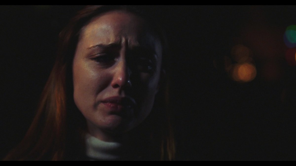

Premium Member Tyler Purcell Posted November 19, 2021 Premium Member Posted November 19, 2021 (edited) This is two hollywooded lights, one LED light on a c stand arm in a chimera to the left of camera and up. The other just open faced, around 30ft down the road to the right, set to a bit colder. Where I wish I had wrapped the face around a bit more and done something with the background, the key is 2 stops under exposed, no push in processing. It's 200T 35mm and I pushed it in the scan. Not what I wanted, but it worked and I guess it's a good example of how ya don't need much light, ya just need "some" light. Edited November 19, 2021 by Tyler Purcell 1
Jon O'Brien Posted November 20, 2021 Posted November 20, 2021 I like the lighting in that shot, Tyler! Looks great to me. 1
Premium Member Tyler Purcell Posted November 20, 2021 Premium Member Posted November 20, 2021 (edited) 3 minutes ago, Jon O'Brien said: I like the lighting in that shot, Tyler! Looks great to me. Thanks, it was a last minute decision. A bit dark for my taste, but it works. Edited November 20, 2021 by Tyler Purcell
