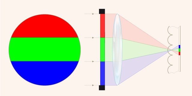

I recently asked my Galileo Digital rep if Lasergraphics had any solutions for successfully digitizing vintage Kodacolor film made between 1928-1935.
I got back a word salad explanation of Kodacolor and a suggestion to "hire a software engineer to write code to convert the lenticle stripes to color (or gray-scale if the scan is B&W). To make the output look good will presumably be difficult and expensive."  (Sure, I'll just get right on that.)

I have scanned some Kodacolor jobs and sent them to Tom at Colorlab for him to process, his GPU based software works and the results are certainly a mixed bag.
Kodacolor was a terrible color process and was made far worse by years of being squished so the lenticular stripes became flat.
At best it is a low res color image with lines and at worst it is a low res B&W image with lines when the processing does not quite see the stripes, I am sure Tom has improved it over time as it has been a few years since I have seen any7 Kodacolor come into the lab.

writing software to do this is something we've messed with as well. It's not difficult in theory, but the biggest problem is that due to shrinkage and warping, the vertical lenticules get out of whack and you wind up with rainbow moire effects. To do it right involves a fair bit of image processing to compensate for all of that first, before applying color to the three channels. It's doable, but a lot of work.
We hired someone a while back to write some code for us to do this, and it kind of worked but only if the film was absolutely pristine and flat, which is almost never the case with 100 year old film...

The scanner (at least ours) can handle warped film, and there aren't any real side effects except for some slight blurring in extreme cases. There are options to install a modified gate, which has a pressure plate to hold the film flat. I think the one from Lasergraphics is too expensive so I've been designing my own. Yet another project...
The issue here with lenticular film is that there are 400 or so lenses baked into the film itself, and those are tiny. Any slight variation causes issues when applying the color to the R/G/B channels that correspond to those lenticules. So any software that deals with this first has to make sure all those lines are perfectly straight. That's doable, but it's a lot of pre-processing, and in cases where the film is really dense it can be hard, if not impossible, to detect the edges of those lines. So you have to make some guesses about where they should be based on what you know of what you can actually see. That's where things get tricky.
