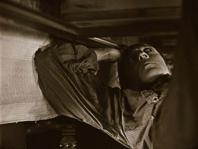

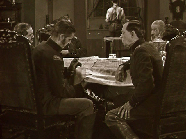

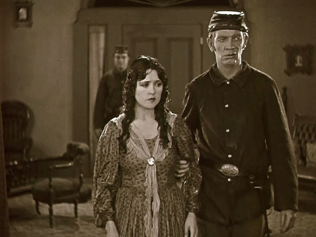

Premium Member David Mullen ASC Posted February 4, 2019 Premium Member Posted February 4, 2019 I only have the DVD of "The General", not the blu-ray, but here are some frames that show the depth of field of a night interior: To my eye, it looks like 35mm film shot with a 50mm at f/2.8-4.0 range. I don't think you could get this effect in Super-8.
