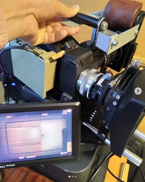

Giray Izcan Posted March 18, 2021 Posted March 18, 2021 I dont see any bars. To be honest though, looking through gg won't yield an hd and a crisp image no matter what.... I agree with Satsuki on Arricam ivs and I'd much rather have the SD IVS tap over diy "hd" taps...

Giray Izcan Posted March 18, 2021 Posted March 18, 2021 (edited) I spent 150 dollars to fit the camera on the elbow but didn't modify the optics so you can see black bars on the sides. It looks more like 1.66 than 1.78 but it works good enough. I am using a 35mm lens but I suspect a 50mm could fill the whole screen without black bars. I like blackmagic colors and dynamic range being similar enough to film with custom wb etc. Edited March 18, 2021 by Giray Izcan 1

Giray Izcan Posted March 18, 2021 Posted March 18, 2021 Your tap looks very nice there in the picture.

Giray Izcan Posted March 19, 2021 Posted March 19, 2021 (edited) I will get my ggs laserbrightened soon at s16 inc. I am guessing that will improve the image quite a bit. Also, I am planning on trying a 50mm lens to punch in more and to hopefully fill the frame entirely. Edited March 19, 2021 by Giray Izcan
Heikki Repo Posted March 19, 2021 Posted March 19, 2021 I also took the DIY "BMPCC as a video tap" -route as well with my Eclair ACL. I haven't really tested it in the wild yet, but my initial tests seemed to show that the focus assist worked even from the ground glass (laser brightened). The issue with my setup is that ACL doesn't have a separate port for a video tap. In order to use BMPCC I need to remove the viewfinder, which is not optimal. Not to mention that the camera isn't that ... ahem ... aerodynamic anymore. For ACLs the other option though would be to go for AZ Spectrum video tap. They are fitted between the viewfinder and the camera, so there is that positive. On the other hand, they all are analog and the prices between $1500 (monochrome NTSC) and $2600 (Color flicker free, PAL). Is it worth it? Do you think I could survive without an optical viewfinder?
