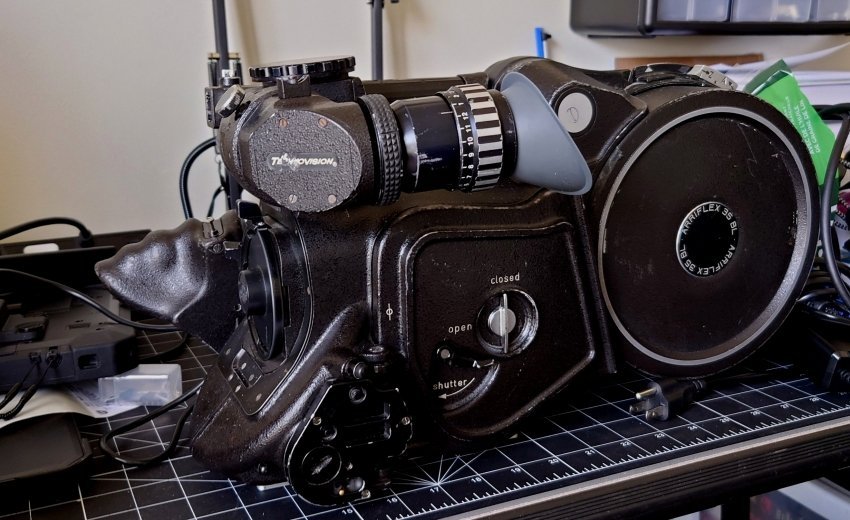

Premium Member Aapo Lettinen Posted July 16, 2024 Premium Member Posted July 16, 2024 9 minutes ago, Xander Kasongo said: I don't know. I'd have to slightly disagree with you on the weight of the BLs - I wouldn't say much lighter. It's 25lbs with the body and mag (empty). There is one sitting on my desk (BL2 image attached) and I can't lift it with one or two fingers. With lenses and kit we clocked in at 34lbs+. I tested the BL2 which had Evolution update and P+S Technik viewfinder, maybe there is weight difference compared to the original version but I don't believe it would be that large difference. I tested the Red One at the same time and specifically remember how lightweight the BL was compared to the RED which only had the top and bottom rods, battery, hdd etc. basic accessories and no lens. And yes I could easily lift the BL with two fingers without lens and even one finger would had been possible though quite uncomfortable. the original BL has lots of fiberglass parts which make it lighter weight than one would assume. but of course it still weights a lot compared to modern digital cameras. and the Evolution updated version might be a bit lighter weight, I don't know it it is the case but the viewfinder and camera door etc. are different and motor control differences etc. though I think the motor is probably the original still

Xander Kasongo Posted July 16, 2024 Posted July 16, 2024 2 minutes ago, Aapo Lettinen said: I tested the BL2 which had Evolution update and P+S Technik viewfinder, maybe there is weight difference compared to the original version but I don't believe it would be that large difference. I tested the Red One at the same time and specifically remember how lightweight the BL was compared to the RED which only had the top and bottom rods, battery, hdd etc. basic accessories and no lens. And yes I could easily lift the BL with two fingers without lens and even one finger would had been possible though quite uncomfortable. the original BL has lots of fiberglass parts which make it lighter weight than one would assume. but of course it still weights a lot compared to modern digital cameras. and the Evolution updated version might be a bit lighter weight, I don't know it it is the case but the viewfinder and camera door etc. are different and motor control differences etc. though I think the motor is probably the original still Interesting, I've never had the privilege of working with the evolution (I can only dream). I also haven't worked with the RED so I can't comment on the comparison of these. But BL1, 2, and 4 I have and it's got its heft. This one however we were trying to rid to a drone but no dice.
