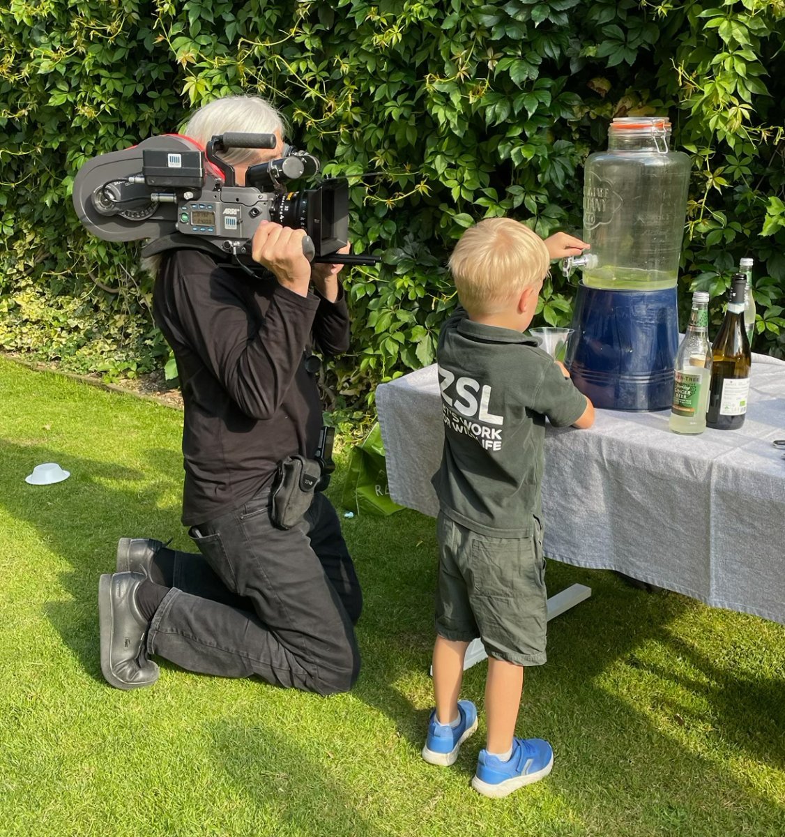

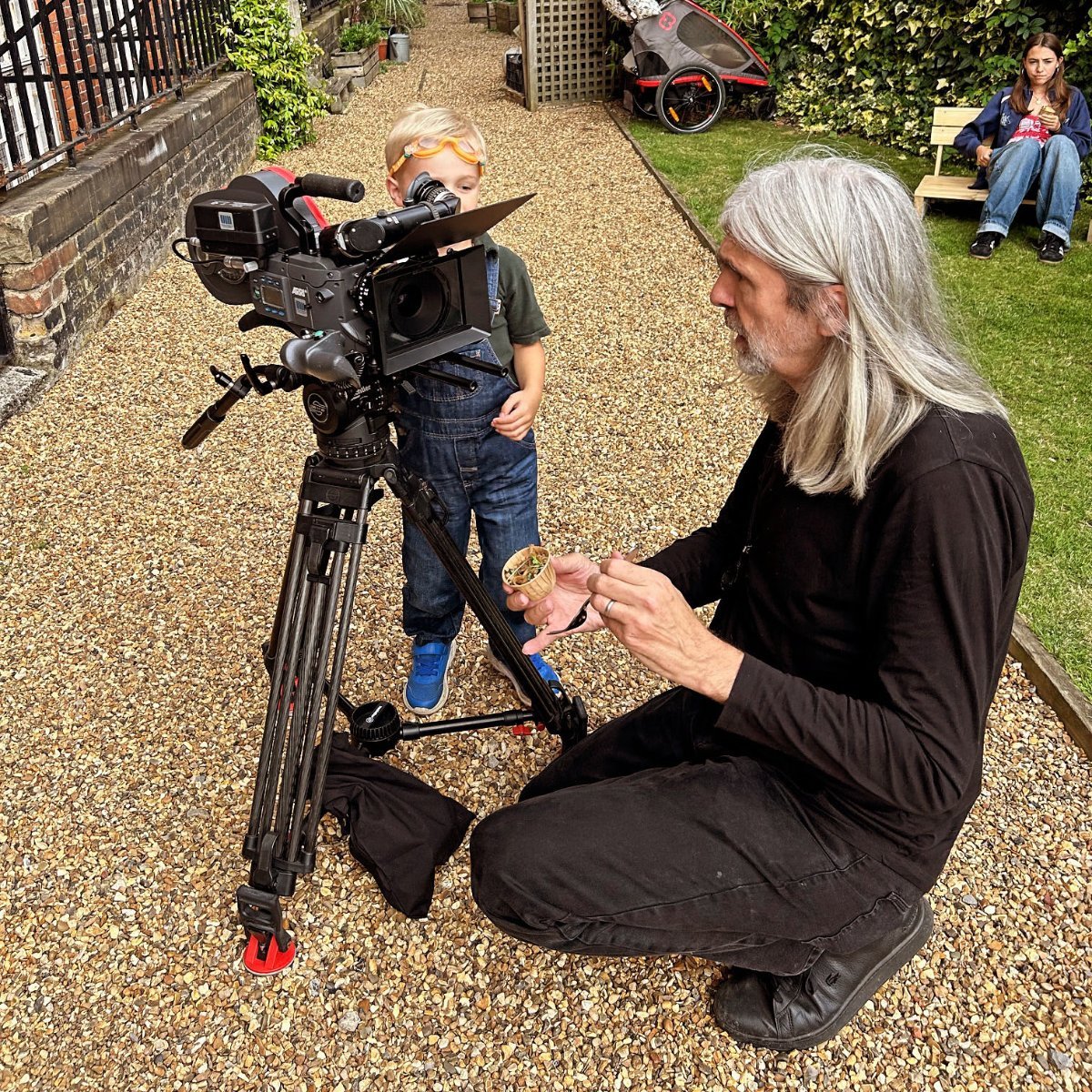

Premium Member Uli Meyer Posted July 18, 2024 Premium Member Posted July 18, 2024 I'm advocating for 35mm, it is the superior film format for my taste. Expensive, yes, that is a painful drawback. Nevertheless, I love it. You can operate a 235 on your own, no problem. I've stripped down my camera to the bare minimum, eliminating the video assist since you don't need it working on your own. I use a riser plate that allows you to mount 15mm rods and a Wooden camera follow focus and lightweight mattebox. The camera weighs 9 kilo with a loaded 400ft mag and a UP. This means that you don't need a massive tripod either. I'm using a Sachtler 1910 Cine 7+7. I build the camera before I go out and it fits easily into my camera bag. It all depends on what you want to do with it. 3 1

Premium Member Uli Meyer Posted July 18, 2024 Premium Member Posted July 18, 2024 (edited) 1 hour ago, Aapo Lettinen said: Compare to Arricam which needs so many boxes that you struggle to haul it around and if fitting to a normal car you can barely get the driver there, no passengers. Again, it all depends on what you want to do. It is possible to strip down an Arricam LT to the bare minimum so you can operate it solo. I've been walking around London with my LT to shoot documentary footage on my own. I took it onto a bus inside my Hamax pushchair, ready built, including a high hat and fluid head. Of course, if you want to shoot narrative, it becomes an entirely different ballgame. Professional shoots don't vary that much when it comes to formats. A Super 16 film shoot with a 416 or an SR3 is not much different compared to one with an Arricam. Edited July 18, 2024 by Uli Meyer 1
Premium Member Moses Buckwalter Posted July 18, 2024 Author Premium Member Posted July 18, 2024 3 hours ago, Uli Meyer said: I'm advocating for 35mm, it is the superior film format for my taste. Expensive, yes, that is a painful drawback. Nevertheless, I love it. You can operate a 235 on your own, no problem. I've stripped down my camera to the bare minimum, eliminating the video assist since you don't need it working on your own. I use a riser plate that allows you to mount 15mm rods and a Wooden camera follow focus and lightweight mattebox. The camera weighs 9 kilo with a loaded 400ft mag and a UP. This means that you don't need a massive tripod either. I'm using a Sachtler 1910 Cine 7+7. I build the camera before I go out and it fits easily into my camera bag. It all depends on what you want to do with it. Hi Uli! I love these shots. Curious as to what you’re doing for power. Does the 235 require 24v as well?
Premium Member Uli Meyer Posted July 18, 2024 Premium Member Posted July 18, 2024 4 minutes ago, Moses Buckwalter said: Hi Uli! I love these shots. Curious as to what you’re doing for power. Does the 235 require 24v as well? Yes, 24 Volt. I had the original batteries modernised by Hawk-Woods. You can see one mounted on the right side of the camera. I do switch off the camera during brakes which means one battery lasts a long time.
