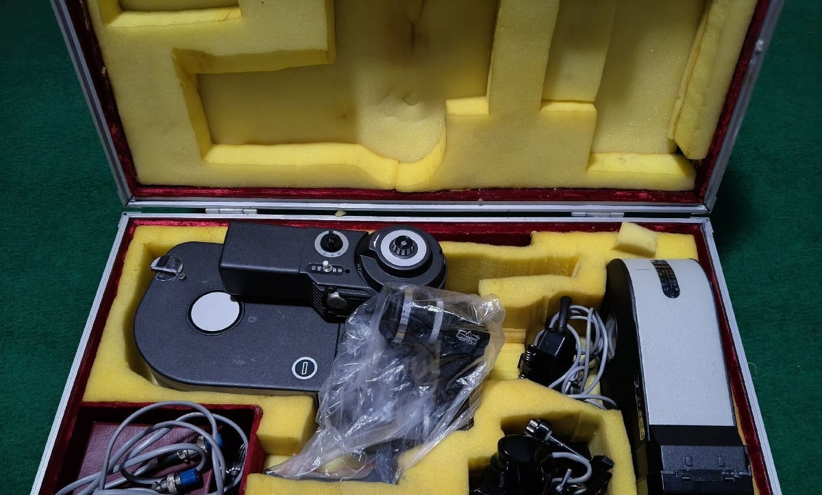

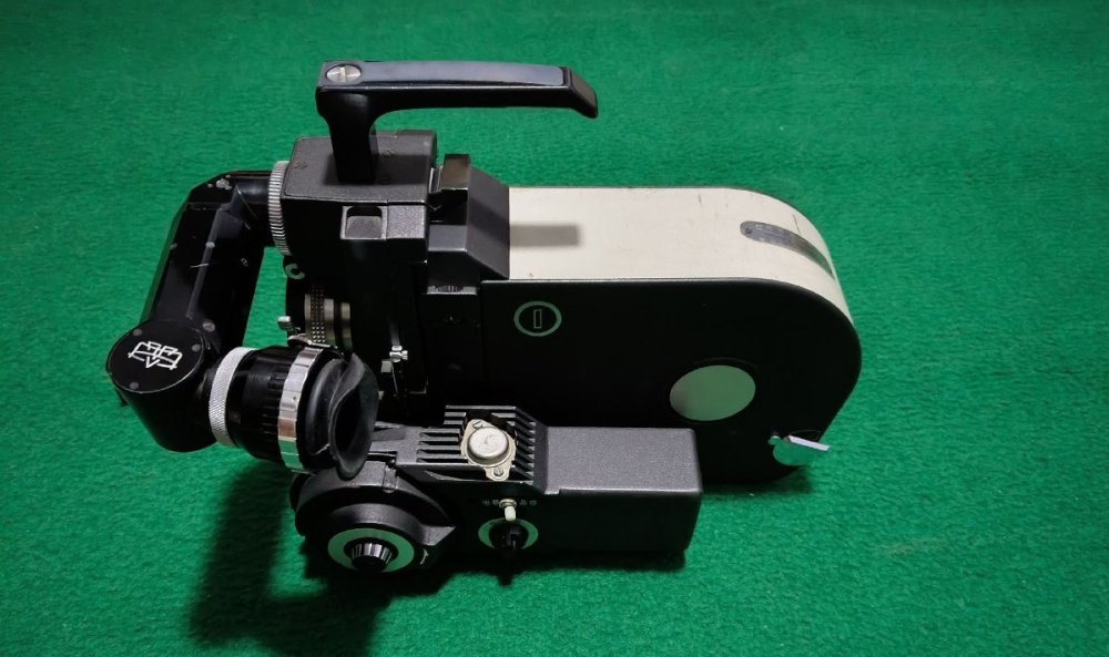

Jason Lu Posted July 17, 2024 Posted July 17, 2024 Hi. I found a very interesting 16mm Chinese camera today, and I would like to share it, the body construction is borrowed from the Arriflex SR but the motor and magazine appear to be of ACL design. 2

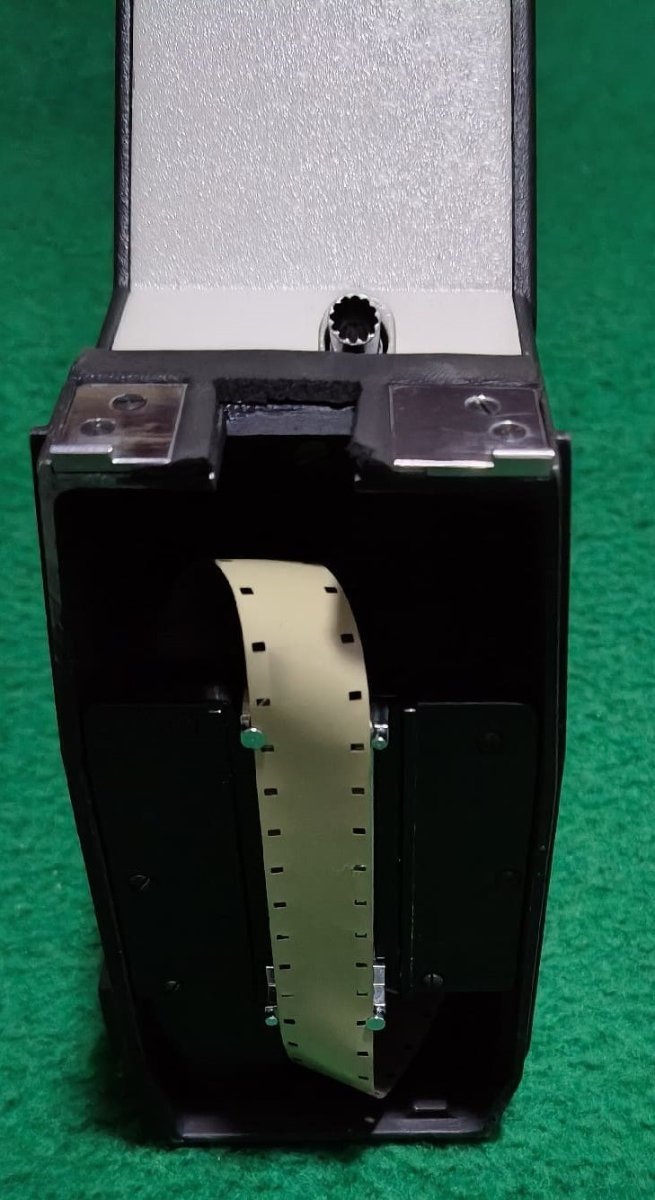

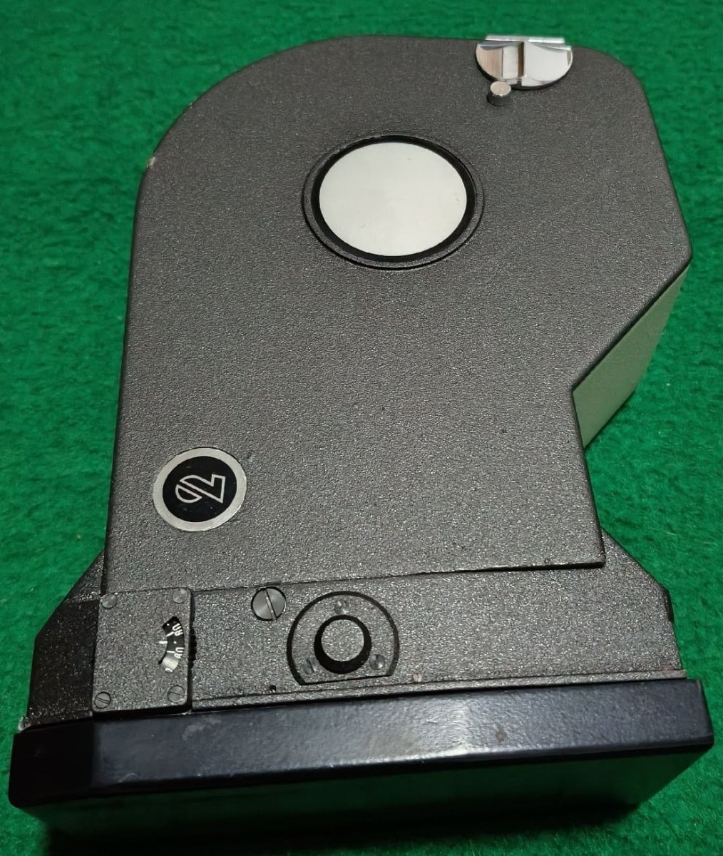

Jason Lu Posted July 17, 2024 Author Posted July 17, 2024 more magazine images Peculiar design, The front is similar to SR, but the overall is closer to Acl.
Jason Lu Posted July 17, 2024 Author Posted July 17, 2024 6 minutes ago, Phillip Mosness said: Do you know when this was made? No, can't find any information about it, only know it's made by GANSU OPTICAL INSTRUMENT FACTORY

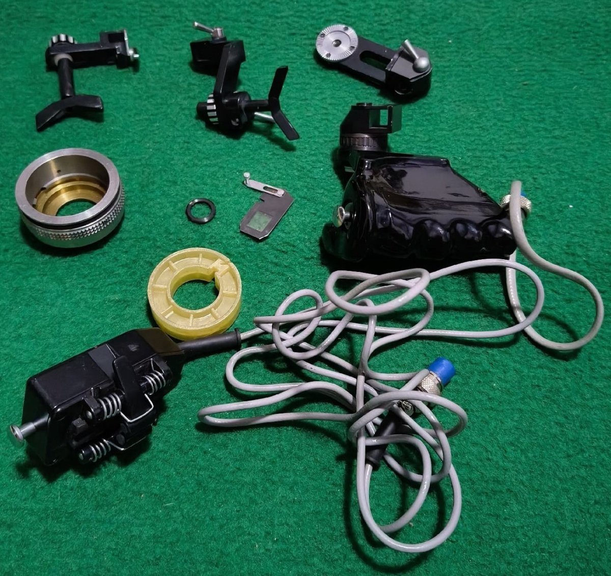

Jason Lu Posted July 17, 2024 Author Posted July 17, 2024 Some accessories, basically the same as Arri SR

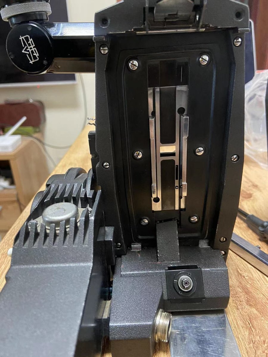

Premium Member Tyler Purcell Posted July 17, 2024 Premium Member Posted July 17, 2024 (edited) Looks like an ACL copy with an Arri viewfinder and pressure plate, which means probably the gate is SR style as well. Interesting. Do you have a picture of the gate? Edited July 17, 2024 by Tyler Purcell
Jason Lu Posted July 17, 2024 Author Posted July 17, 2024 7 minutes ago, Tyler Purcell said: Looks like an ACL copy with an Arri viewfinder and pressure plate, which means probably the gate is SR style as well. Interesting. Do you have a picture of the gate? Sorry, only got those images about the camera body. I don't own this camera, just saw a guy selling it. He was also selling some projectors and film-related books. I guess he found them in a deadstock at a film factory.

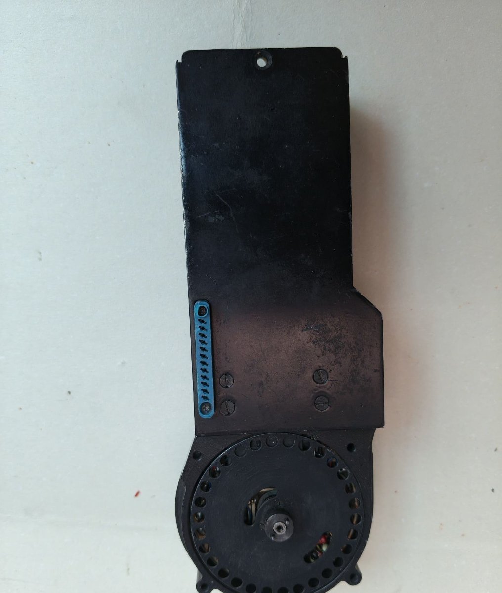

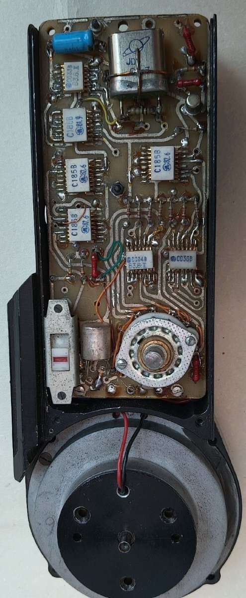

Jason Lu Posted July 17, 2024 Author Posted July 17, 2024 He is also selling an extra motor. Some photos of motors. Very similar to the ACL, the connections are in the same place but the shape is different.

Premium Member Tyler Purcell Posted July 27, 2024 Premium Member Posted July 27, 2024 I think they bought old SR parts and basically couldn't figure out how to drive them, so they build that big board/motor that sticks of the side. Because honestly. that movement looks like it came out of an SR and I don't think they would have gone to all that trouble to re-design it. Very odd.
Travis Shannon Posted July 27, 2024 Posted July 27, 2024 Looks dope if a bit heavy, 144 fps is wild. Can anybody tell what mount it is? TS would be rad.
Jason Lu Posted July 28, 2024 Author Posted July 28, 2024 A friend of mine bought this camera and sent it to me for lubrication. The name on the magazine is 甘光(GANSU OPTICAL INSTRUMENT FACTORY) S16 XW, I am still trying to find the manual. Yesterday I disassembled part of this camera and compared it with my ArriflexSR&EclairACL. The conclusion is that S16XW does not use any SR&ACL original parts. Looks similar but the details are different. The magazine looks like an ACL magazine, but its internal structure is identical to an SR magazine. The viewfinder is the same as the SR, but the release screw hole of the viewfinder is directly below the viewfinder instead of built-in. The design of this camera is based on the Arriflex SR and Eclair ACL. The factory should have obtained these two cameras, measured and mapped them, combined the parts that were easier to make, and cancelled the built-in motor of the SR and the reflector structure of the ACL. The motor speeds are T2/48/36/24/12. 1
