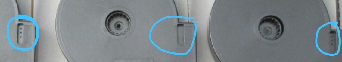

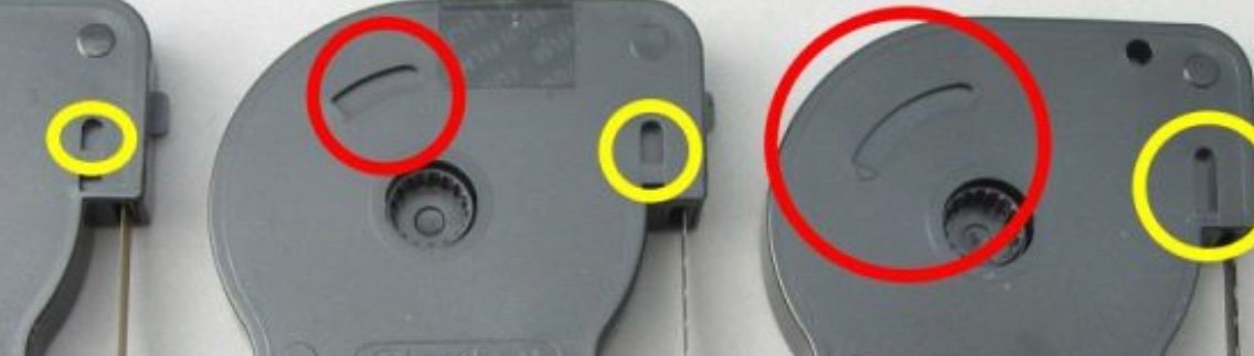

Joerg Polzfusz Posted September 8, 2024 Posted September 8, 2024 (edited) Funny side note: Single8-cartridges also have a third „hole“/„notch“ to inform a camera about the film’s sensitivity - see the yellow circles. This is defined in the standard, but I haven’t seen a camera that uses it. And there are even more „holes“/„notches“ that are not described in the standard - see blue circles. They have probably only been used by Fuji’s lab to automatically distinguish between color and B&W films. Photos are from Muddy‘s page - https://www.muddyfilm.net/2006/04/single8speedset.html and show 25 ASA (daylight color), 50 ASA (B&W) and 200 ASA (tungsten color) - from left to right. Another strange observation: in these images, only the cart for the RT200N has got a lower „nose“/„nib“?! (Only visible on Muddy‘s webpage as I had to reduce the image size here on the board.) Edited September 8, 2024 by Joerg Polzfusz
