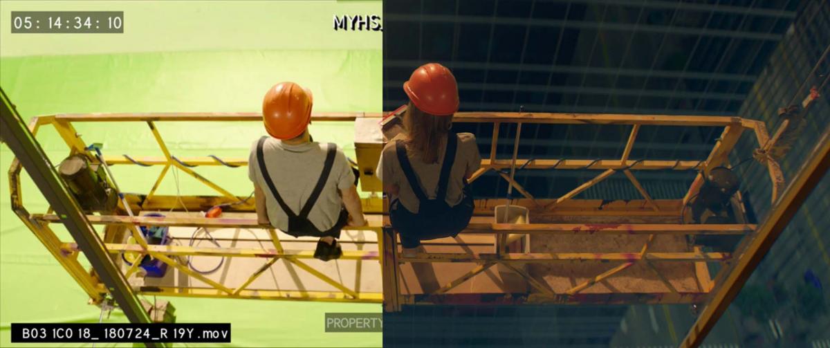

Bruce Greene Posted December 9, 2018 Author Posted December 9, 2018 some movie magic... This is part of one continuous technocrane shot that flies over a conference table and out the window over the city below...
Bruce Greene Posted December 9, 2018 Author Posted December 9, 2018 The ending frame and first frame full composite

Bruce Greene Posted December 17, 2018 Author Posted December 17, 2018 The ending frame and first frame full composite I found a BTS photo of shooting the big VFX scene...
Alissa Alexina Posted January 15, 2019 Posted January 15, 2019 Thank you! The VFX work looks impressive. And really like Dedolights on medical stands:) 1
