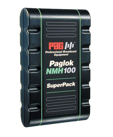

Premium Member Phil Rhodes Posted March 13, 2019 Premium Member Posted March 13, 2019 I still have... 1

Bruce Greene Posted April 9, 2019 Posted April 9, 2019 On 3/13/2019 at 4:58 AM, Phil Rhodes said: I still have... Me too!!!! ? Secure grip. No wiggle. I use them for Steadicam.

matthew field Posted October 13, 2021 Posted October 13, 2021 The PAGLok was a leverage system, based on a locking system in the navy. This is regretfully phased out in favour to the two systems, the Gold Mount and the V-lock. The Gold mount is favoured by steadicam operators for their stability. Fortunately PAG supports both V- mount and Gold mount. If anyone has questions - please do not hesitate to speak to us (support@paguk.com)
Bruce Greene Posted October 13, 2021 Posted October 13, 2021 On 3/13/2019 at 4:58 AM, Phil Rhodes said: I still have... I still have and use this system :)
