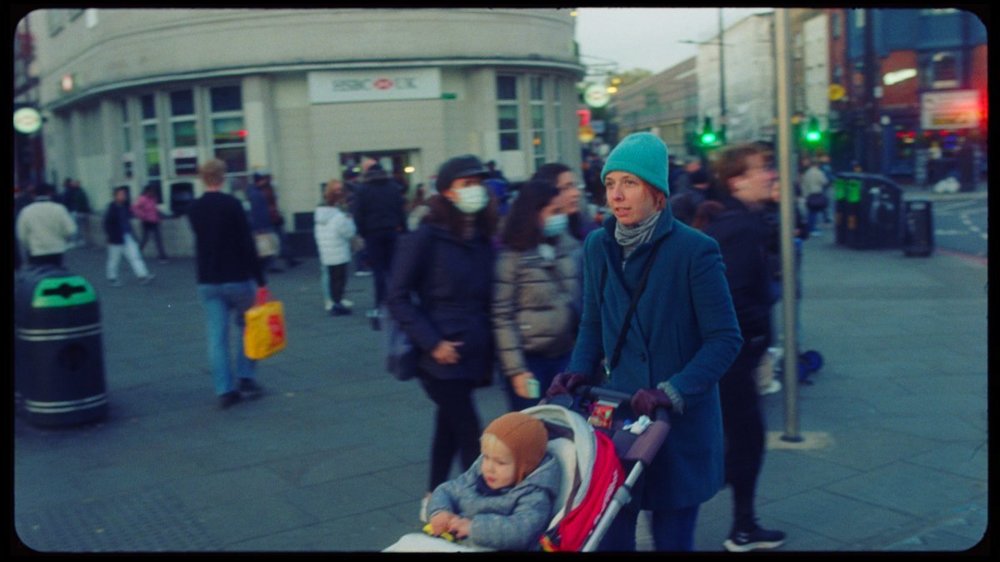

Premium Member Uli Meyer Posted February 16, 2022 Premium Member Posted February 16, 2022 500T at dawn shot without any filter. These are very quick basic grades done in Premiere without going into colour specifics. I like the slightly unreal colours that you get when shooting Tungsten in daylight. 4

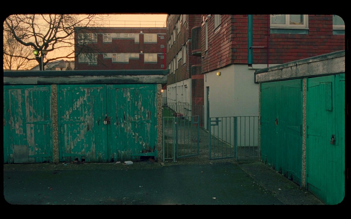

Premium Member Uli Meyer Posted March 15, 2022 Premium Member Posted March 15, 2022 A couple more screen grabs of footage shot with 500T in daylight.
