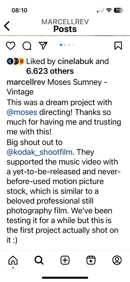

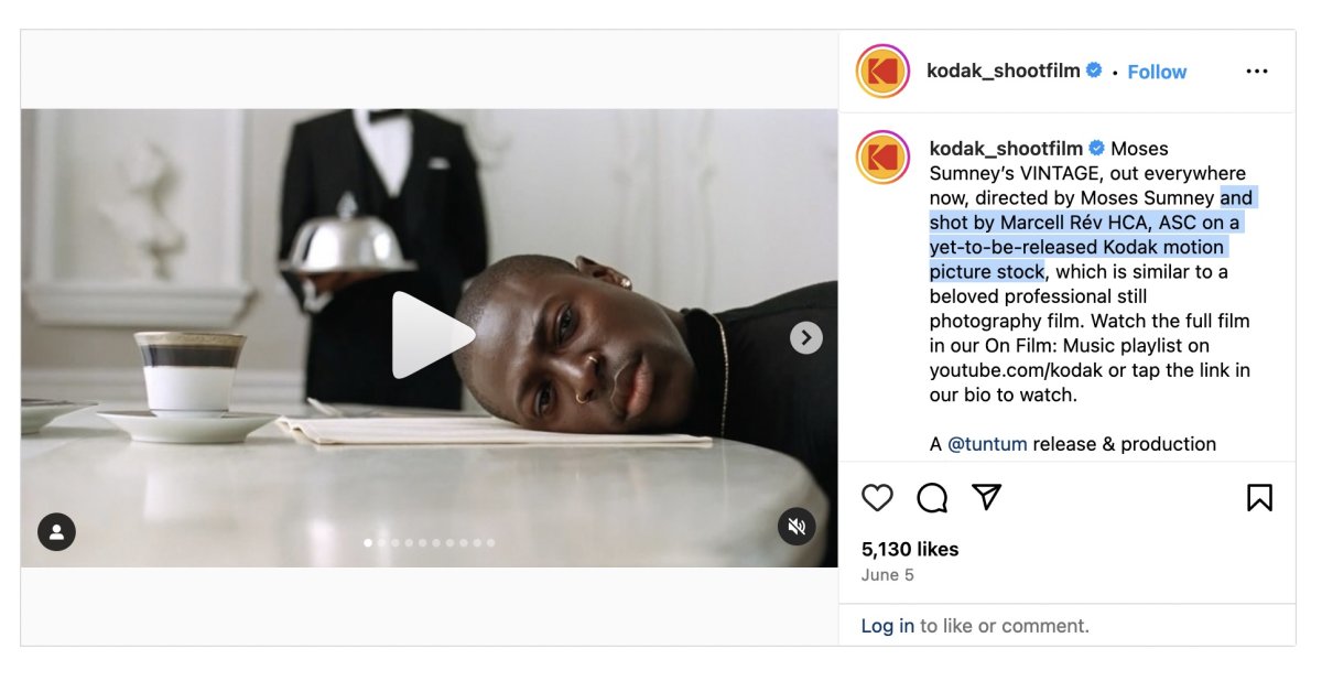

Gautam Valluri Posted June 20, 2024 Posted June 20, 2024 Hello all, I just came across this from the Kodak instagram page, a new Moses Sumney music video shot on "a yet to be released film stock" by Kodak : Nkosi Roma on Youtube speculates that it could either be a ECN-2 version of Portra or a new Vision3 400D stock. Anybody know anything about this? Here's the music video for those interested, some good images:
Premium Member Tyler Purcell Posted June 21, 2024 Premium Member Posted June 21, 2024 I know a bit about what's going on, but I don't think I can really spill details yet. Suffice to say, it's not a "new" stock at all. It's simply a still film that's been made to work in a motion picture film camera with the proper coatings and lubrication. I'm not sure it even has an anti-halation coating, but obviously it's ECN-2 based. In terms of ISO, my educated guess is that it's 400 iso. Why? It just makes sense. They have 50, 100 (Ektachrome), 200, 250 covered. What they don't have is a finer grain, but still sensitive stock. The cool thing about still film, is that it's not necessarily daylight OR tungsten. So using a still film for motion picture, would be very interesting and deliver a result that may work really well for mixed light sources where you aren't so beholden to a single color balance like with standard motion picture stocks. We aren't printing these days, so why does any of the stocks truly need to have a meaningful color balance one way or the other. I almost feel Kodak should be making more generic run of the mill color balance stocks. Maybe make a 50D for daylight and a 500T for tungsten, but everything else in the middle COULD be 4k rated. Release date is unknown, but from what I understand, more information will come out this summer. 3 2

Premium Member Stephen Perera Posted June 21, 2024 Premium Member Posted June 21, 2024 From Marcel Rev...
