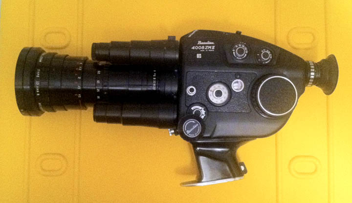

Premium Member Will Montgomery Posted January 28, 2019 Premium Member Posted January 28, 2019 ...and they have by far the best lens in Super-8 world (despite people claiming otherwise I love Nikon but better than this lens on the black Jubilee edition? Angenieux f1.2 6-80?
Andries Molenaar Posted January 28, 2019 Posted January 28, 2019 (edited) I love Nikon but better than this lens on the black Jubilee edition? Angenieux f1.2 6-80? I'll give it a try some sunny day, on rare document film in super-8. I have both cameras and a tripod. :) Edited January 28, 2019 by Andries Molenaar
