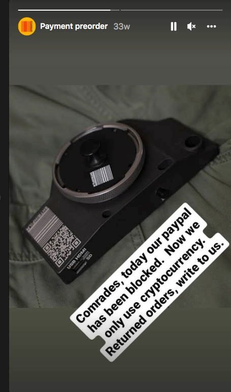

Anyone would have to be out of their mind to trust this guy Max Ivanov with your money after reading about my experience purchasing one of his Canon Mount K-3s.  Once I made the purchase, I had a feeling I would never see the camera or the money, and that is what happened.
I purchased the K-3 in April of 2021, and have received nothing since but false promises, and no refund, or any responses since last summer. There is one side to this story, only myself being ripped off, and a guy in Russia who stole my money.  And someone is on here trying to send business his way?
There is no accountability since he is in Russia, except maybe this forum full of cinematographers.  He continues to show videos of modifications to the K-3 on the internet.  If he couldn't send me a Canon mount K-3 with a ground glass modified viewfinder, how can his other experiments with the K-3 be worth thousands of dollars?  Who would risk sending their money to someone who has said in the past (after my purchase) that people must use cryptocurrencyy due to being blocked on Paypal?  If anyone questions the veracity of my post, then please send me a message.
Please do not let this con artist use this forum to rip other people off.  I learned the hard way, and I have seen another disgruntled customer ask Max Ivanov about his camera that was not delivered as well, so surely there must be others.  If he couldn't deliver on time, then he should have issued refunds.  He simply stops communication, so this is the result.
Aw man I'm really sorry about that. I know a few people who have gotten their cameras without any issues so I really didn't think he would be scamming people. I'll update the post. EDIT: I'm not able to edit the original post any longer unfortunately, otherwise I would add a disclaimer at the top regarding your situation..
