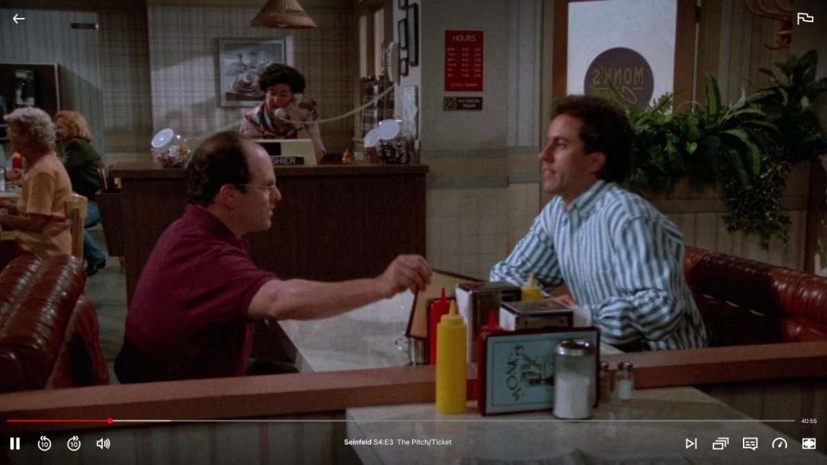

Premium Member Uli Meyer Posted November 17, 2021 Premium Member Posted November 17, 2021 Shows like 'Seinfeld' and 'Friends' are currently streaming on Netflix here in the UK and show a lovely grainy texture. I believe both were shot on 35mm 3perf, 200 Tungsten. The image of the graveyard is from a short film I shot on 35mm 3perf 200 T and it is less "grainy", shot on Vision 3 stock. I kind of like the heavier texture of the TV shows, I have to admit.
