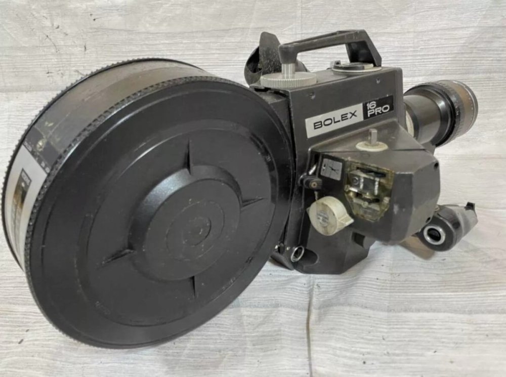

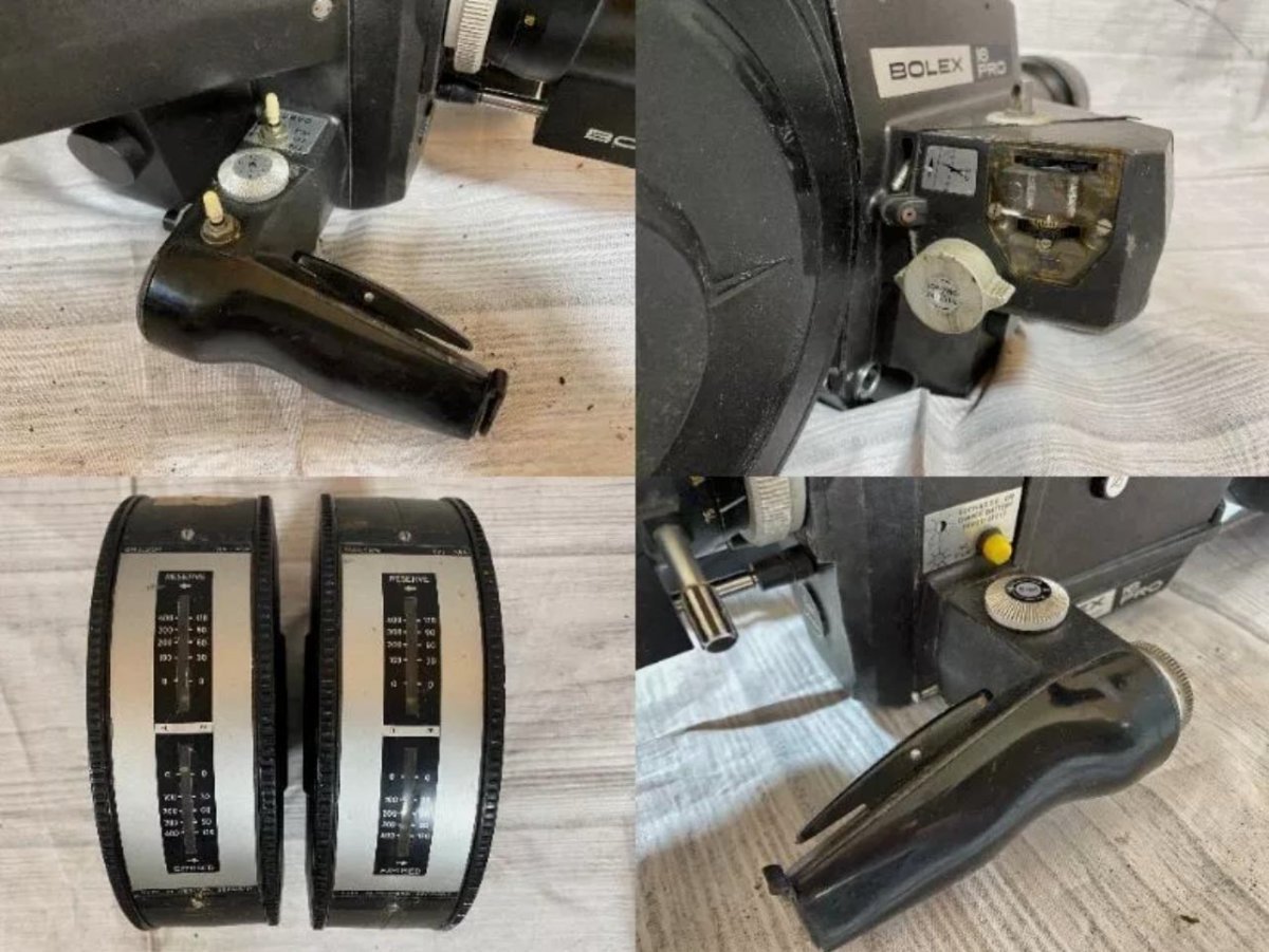

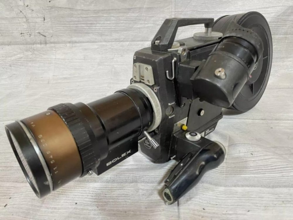

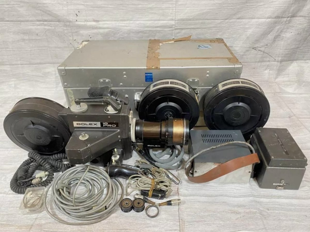

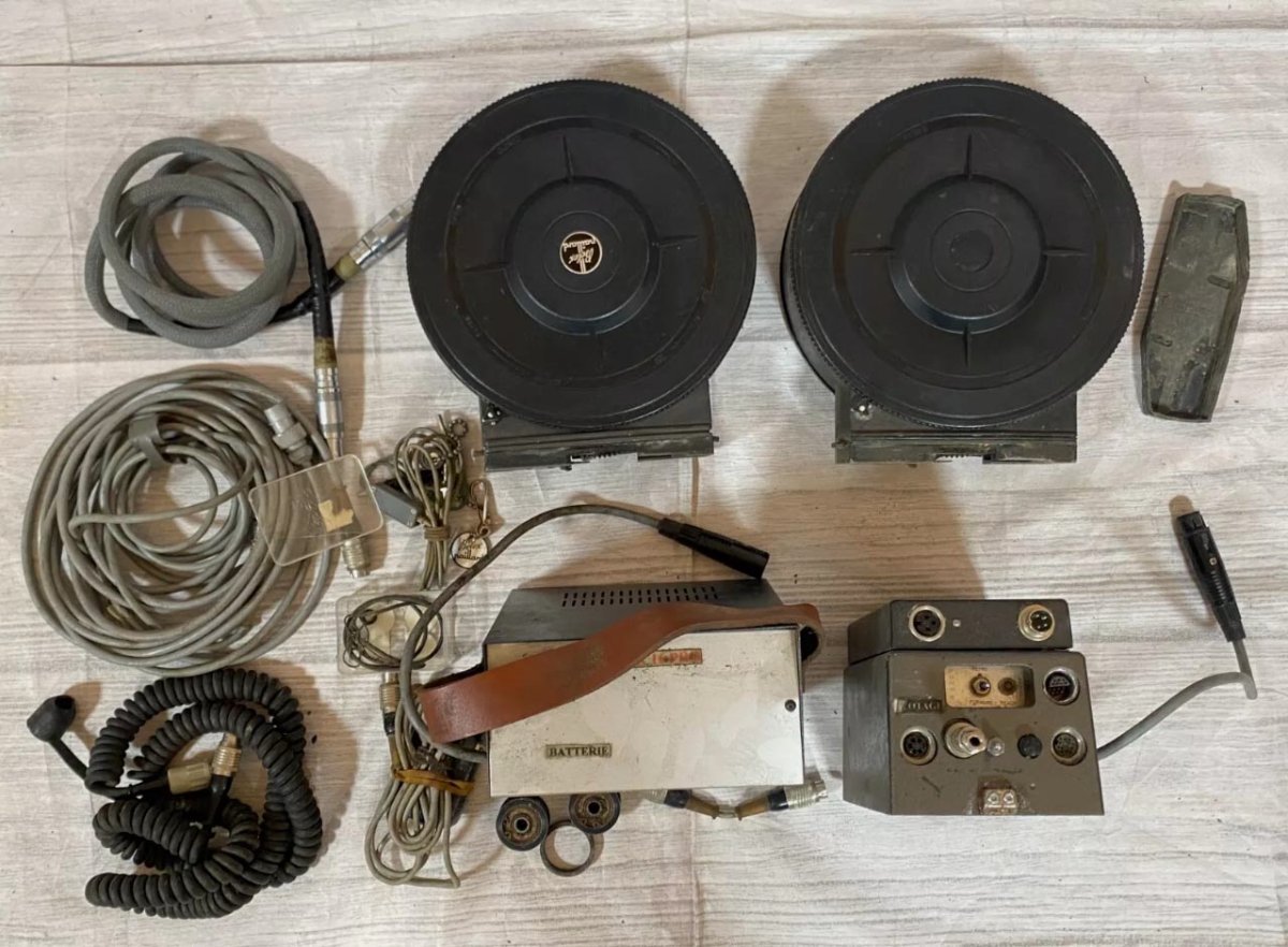

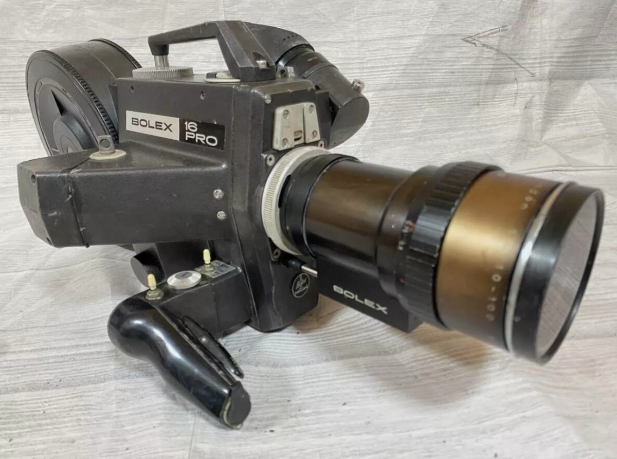

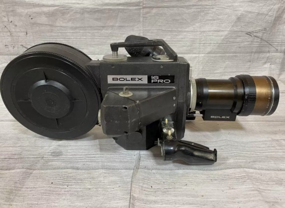

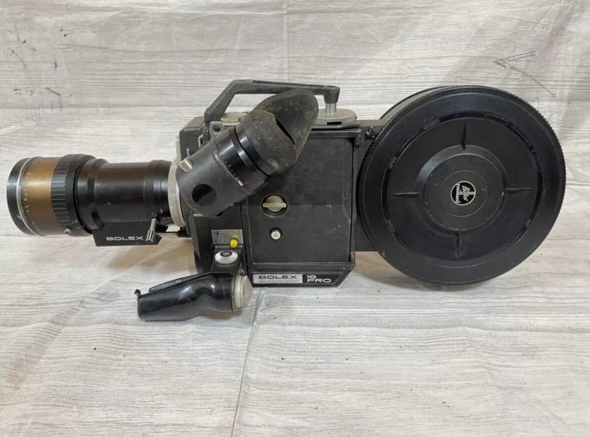

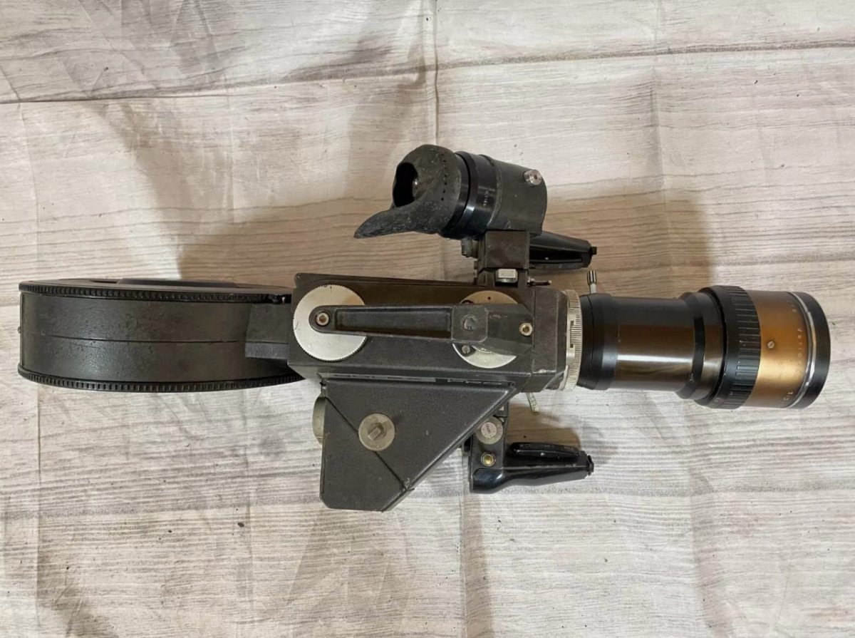

Premium Member Duncan Brown Posted July 11, 2024 Premium Member Posted July 11, 2024 (edited) I hate including an ebay link in a post, because a couple of months from now the link will be dead, and someone searching this site years from now will be really frustrated. HOWEVER, you don't see a Bolex PRO every day so this seems worth posting: https://www.ebay.com/itm/355841511332 It's a legit seller (I bought some ACL mags from him and received them in short order) so at least it's not the usual scams, but obviously no way to know for sure the condition; he's just a bulk reseller. I'll try to at least attach some pics from the auction, for the historical record. Duncan Edited July 11, 2024 by Duncan Brown

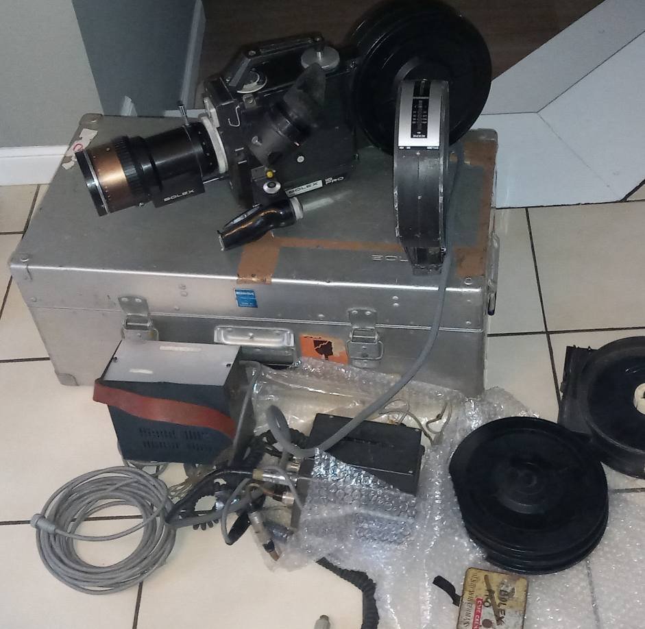

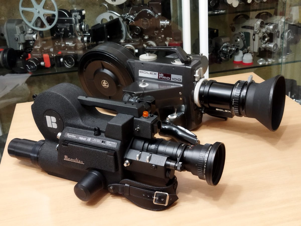

Pascal Becker Posted February 25, 2025 Posted February 25, 2025 Hello, I bought the BOLEX 16 PRO camera that was at the beginning of this topic. It arrived from Japan a few days ago. It was quite complete with all the cables. I did not test it, that was not the goal, I restored it to be exhibited. It is missing the lens hood and the part that contained the battery. A battery box was handcrafted by its previous owner. Before Japan, it was in France until 2000, it is now in Belgium.
