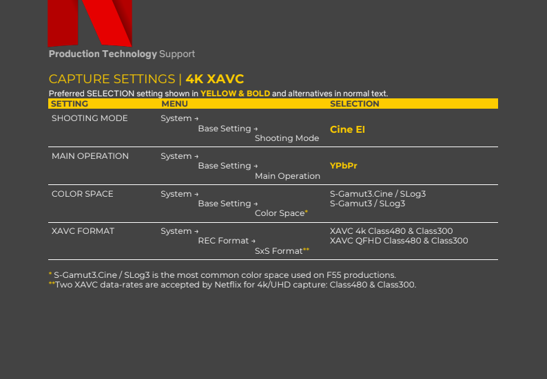

Samuel Berger Posted September 18, 2024 Author Posted September 18, 2024 1 hour ago, Giray Izcan said: I haven't met a single editor who wants or is ok with editing raw files. Same. I might just use ProRes 4444 or XAVC 480. Netflix suggests XAVC 480, S-Gamut3.cine/Slog3. Here is the suggested method:
