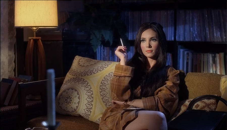

Premium Member Adrian Sierkowski Posted July 20, 2015 Premium Member Posted July 20, 2015 I keep getting super drawn to that lamp-shot. Really fantastic look.

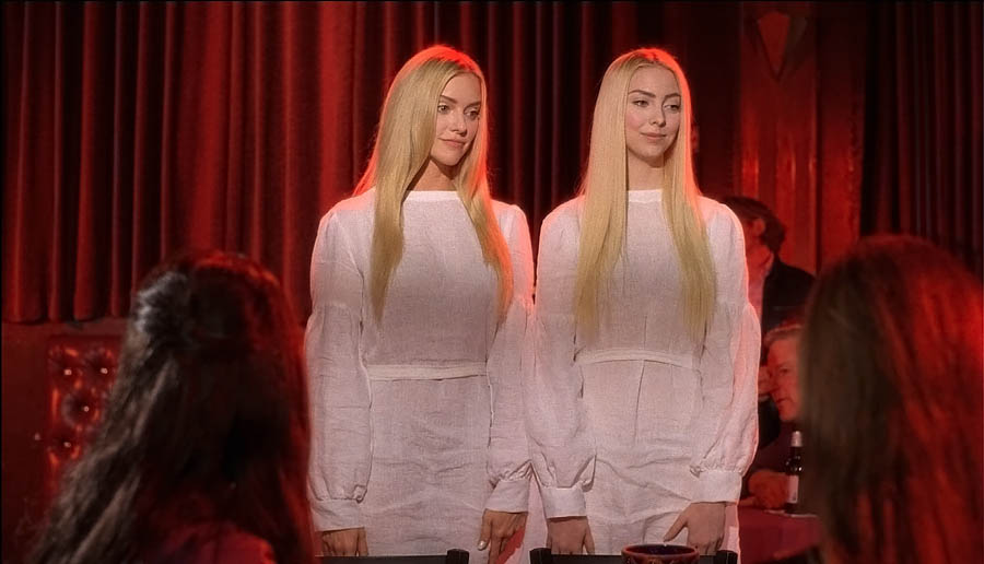

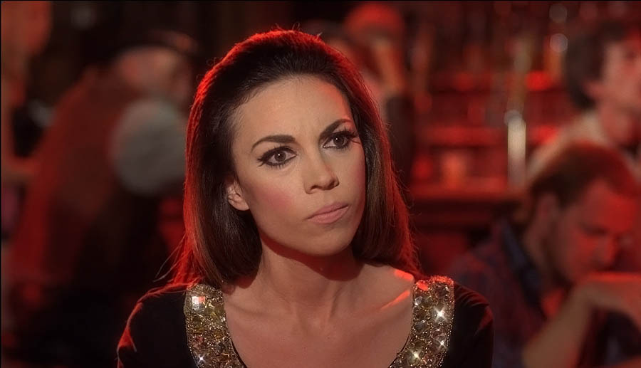

Premium Member David Mullen ASC Posted July 21, 2015 Author Premium Member Posted July 21, 2015 One of the advantages of an all hard lighting approach is how easy it is to flag and shape a light. For example, in this bar/nightclub scene I keyed these two actresses with a 1K fresnel and to put a shadow across their white dresses, I just put a strip of 1" black paper tape across the barndoors on the 1K: Same here on this close-up -- I used some 1" back tape on the barndoors to shadow her neck: This shot is also an example of the typical diffusion on the lens -- my black tule material (creating the X-shaped glints & kicks) + 1/8 Classic Soft. 65mm Zeiss Super Speed at f/2.8. It was interesting to light a whole nightclub space to 100 ASA, mostly with a lot of 2K Juniors rigged to the ceiling, plus 1K ParCan spots. Some of the 2K's had red gel on them for high backlights, and for the coverage, I sometimes had to add a red-gelled Source-4 Leko backlight on a stand to get more intensity, especially for the brunettes. 1
Premium Member Phil Rhodes Posted July 21, 2015 Premium Member Posted July 21, 2015 How much of a relight did that entail, for reverses?

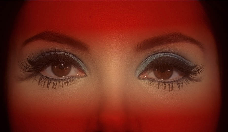

Premium Member Bill DiPietra Posted July 21, 2015 Premium Member Posted July 21, 2015 Most effects are done in-camera -- for example, I used a kaleidoscope lens for this shot: I created a red grad effect by cutting a slit in a red party gel taped to the matte box, about six inches away from the lens to control how sharp-edged the effect was. You can see the star-type flare from the Dior net on the lens in the reflection in her eye: The deep blue moonlight is my little homage to Douglas Sirk / Russell Metty and "Written on the Wind"... A good example of the effect of using 200 ASA stock rated at 100 ASA and the high light levels involved -- I had 150w light bulbs in these practicals and they are barely reading as being on! This shot, like most, was lit to an f/2.8 and shot on Zeiss Super Speeds. Generally key lights for a scene like this would be a direct 2K fresnel, or a 1K fresnel for closer shots: Amazing work, David. The red lighting immediately reminded me of Suspiria and the other shots look like Technicolor prints. Gorgeous stuff.
Premium Member David Mullen ASC Posted July 21, 2015 Author Premium Member Posted July 21, 2015 How much of a relight did that entail, for reverses? For that bar location, it mainly just meant moving the key and red edge light around (we covered about five people in a circle around a table, then other people by the bar and on the stage, etc.)
