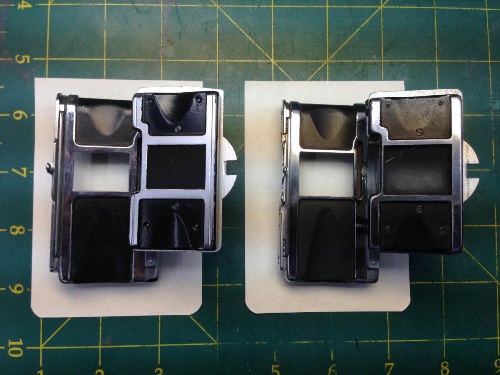

Premium Member Tyler Purcell Posted April 24, 2025 Premium Member Posted April 24, 2025 On 4/22/2025 at 5:12 PM, John Rizzo said: Tomorrow myself and some local DPS are going to TCS and will be testing the non remjet 7219 7207,7213 and 50D on a Arri 416 these DP s are concerned because most 16mm cameras have chrome backplates. Aaton 16mm cameras don't have chrome backplates, they are specifically designed to deal with black and white film which has no remjet. Arri cameras have chromed backplates, across the board. I know some people did make modified pressure plates which were black, but there aren't enough to go around. My main concern are the Arri 2Cs, Arri 35-3, 425, 235, Arricam, Moviecam, 416, SR, etc. We have some ideas on how to solve this problem, but without tests, I don't know if it's worth it. Currently Kodak has new stock available, but they won't give me a roll to test.
Premium Member Dom Jaeger Posted April 24, 2025 Premium Member Posted April 24, 2025 1 hour ago, Tyler Purcell said: Aaton 16mm cameras don't have chrome backplates, they are specifically designed to deal with black and white film which has no remjet. Don't Aaton XTR mag pressure plates have two chrome strips running down the middle? LTR mags have four chrome strips if I recall. 1 hour ago, Tyler Purcell said: My main concern are the Arri 2Cs, Arri 35-3s, .. Arri 2C pressure plates aren't chromed behind the film, only around the outside of the frame. If memory serves Clairmont Camera had a bunch of 35-3, 435 and Arricam pressure plates blackened for use with B&W film. I wonder what happened to them.

Premium Member Tyler Purcell Posted April 24, 2025 Premium Member Posted April 24, 2025 2 hours ago, Dom Jaeger said: Don't Aaton XTR mag pressure plates have two chrome strips running down the middle? LTR mags have four chrome strips if I recall. That actually doesn't effect anything evidently. 2 hours ago, Dom Jaeger said: If memory serves Clairmont Camera had a bunch of 35-3, 435 and Arricam pressure plates blackened for use with B&W film. I wonder what happened to them. Yea, well Andree didn't get them, he's trying to get some made. So who knows.

Dirk DeJonghe Posted April 24, 2025 Posted April 24, 2025 Tyler, We had problems with Aaton XTR with 7222, it shows up as vertical stripes on panning shots over a grey wall for example; this can happen if you overexpose. The light striking the emulsion is travelling through the emulsion and getting reflected off the shiny parts of the film pressure plate and exposing the emulsion from the back a second time. Never a problem with regular rem-jet color negatives. This happened on Aaton 35 as well (5222 only). Also the Lasergraphics film recorder's pressure plate had to be blackened because the diagonal pattern would show up on direct to color positive filmouts.

Premium Member Tyler Purcell Posted April 24, 2025 Premium Member Posted April 24, 2025 9 hours ago, Dirk DeJonghe said: We had problems with Aaton XTR with 7222, it shows up as vertical stripes on panning shots over a grey wall for example; this can happen if you overexpose. The light striking the emulsion is travelling through the emulsion and getting reflected off the shiny parts of the film pressure plate and exposing the emulsion from the back a second time. Never a problem with regular rem-jet color negatives. I've shot a bit of 7222, never noticed it. I guess it depends on exposure. Also 7222 is a different backing, Kodak has already said they're using a silver backing on this new stock to prevent the added halation, so hopefully it works? It looks more like the Ektachrome backing and having shot a bunch of that, never seen it either. The Aaton 35mm cameras have chromed pressure plates, so that would be a problem. I need to first see the results and get feedback from people using chromed gates. If there are no real issues, then we'll just all move on. If there are issues and people have cash to deal with them, I can easily have new pressure plates for the Aaton cameras made, no big deal. I have all the specs, it would be a cinch to model them and get them made with DLC coating. I'm pretty sure there won't be any issues, because the stock is currently being used on a wide array of productions without modified cameras evidently. 1
